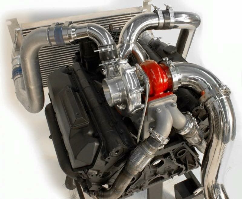

So I recently purchased a T4 kit for my truck, bought it from a guy in Oregon, I will be writing a thread on how it went together sometime next week.
In the meantime, I am looking for advice on a CCV reroute. I am pretty sure the new intake pipe doesn’t have a bung for the CCV. If not I was looking to make an atmosphere drain system.

Finished up the job this afternoon.
Had 99% of it done yesterday, needed to get some 1/8 NPT plugs for the intake Y.
Kit had some small issues with the down pipe (bracket for auto trucks needed to be cut off)
Pedestal needed to be ground a little for my "custom" fuel line.
Needed to cut some boots down to size.
But all in all a very nice kit and well thought out.
Pictures will come tomorrow or Tuesday depending when i get out of class.
Sellers Facebook page is Obsession Diesel Performance, helpful and will work with you on the kit (I didn't need all the boots and clamps)
Overall this kit cost me ~100$ more than a CSD kit with a new driver side intercooler pipe, so i didn't mind buying the "expensive" option.

Will those intercooler pipes fit under our hoods? They look like they route differently?

The pipes should fit. There is quite a bit of space under the hood.
Are the two ports on the top of the collector for EGT sensors?
Looks like a well thought out and nice kit. Well done sir! We look forward to your thoughts on the performance gains.

Yes the pipes fit with about 1/4" of room, they go above the PS line
Yes the two ports are for EGT probes, mines already in the manifold so I had to plug mine with the supplied plugs.
So far the difference between my D66 and this S364.5SXE is night and day.
The D66 spooled up around 1900RPM and this turbo spools up at around 1500RPM.
Thing i love the most is i don't need to push 20PSI to get moving on the highway, its usually 10PSI max on the on ramp.
Can't say anything about towing cause I only tow in the spring, summer and early fall (boat) but i have a tough time getting above 800 EGTS in my race tune.
I am waiting for new IC clamps cause im too lazy to try to install my tight fitting clamps, and the current ones barely snug them up.
Every pipe on this kit is polished SST.
It took me 10 minutes to install the up pipes compared to an hour for my bellowed up pipes, they are very easy to line up with the v band clamps.
I can get actual numbers in an excel spreadsheet if anyone cares to see how the SXE preforms.
