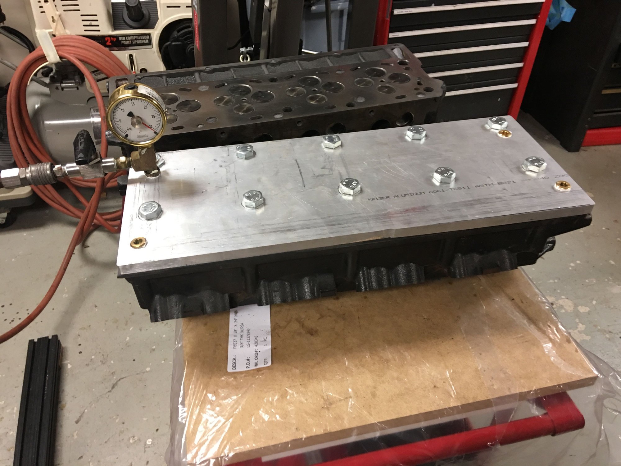

While using the Restore rust removing cleaner would sound ideal, it's basically Citric Acid BTW, it and CA need to get up to a minimum of around 175F for it to work properly. Not going to happen without a running truck. You can use Apple Cider Vinegar since it's an acid, and I did, but then you have to seriously rinse it out and neutralize it with baking soda, I did that too. The problem is it flash rusts unless you do everything perfect. Then I moved to Evapo-Rust, cheapest at Amazon which worked very well but it does leave a carbon trail. it all takes trial and error.
To do it with both the heads and block I used the aluminum plates I made to pressure test the heads. Ports were included as I knew I was going to do this. For the block I used the original head bolts and plastic standoffs, but later just used 3/4" sockets to be able to squeeze better.
It doesn't show all the fittings, hose and other block offs. But it worked well, one side at a time. Probably easier with a front cover so both sides are done at the same time.
