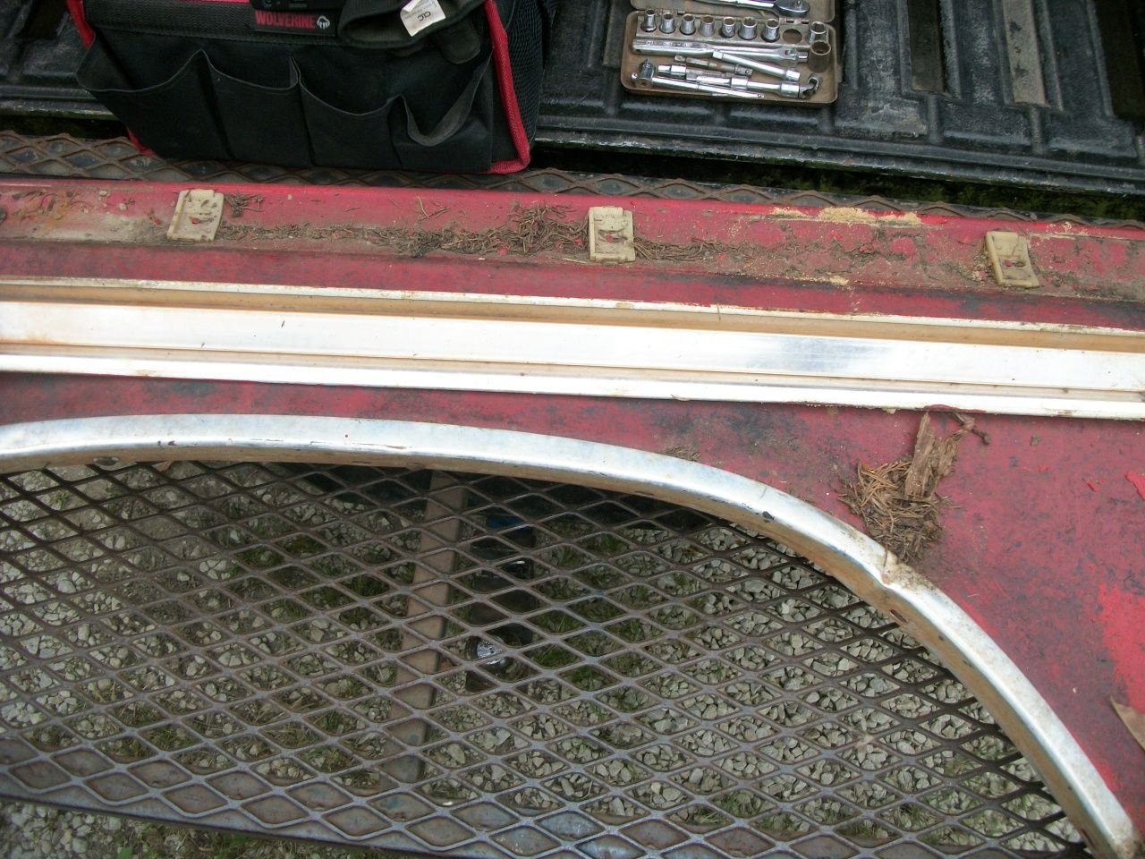

AFAIR each separate "dent" piece has a stud and nut on each end. And then X amount of plastic clips in the middle, held on by rivet head like stud. The plastic clip just slides off of it.
Mask off on both sides of trim with painters tape to prevent scratching truck. With trim off you will still have the rivet head like studs to deal with. AKA BODY WORK time.

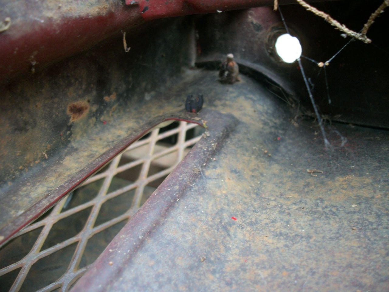

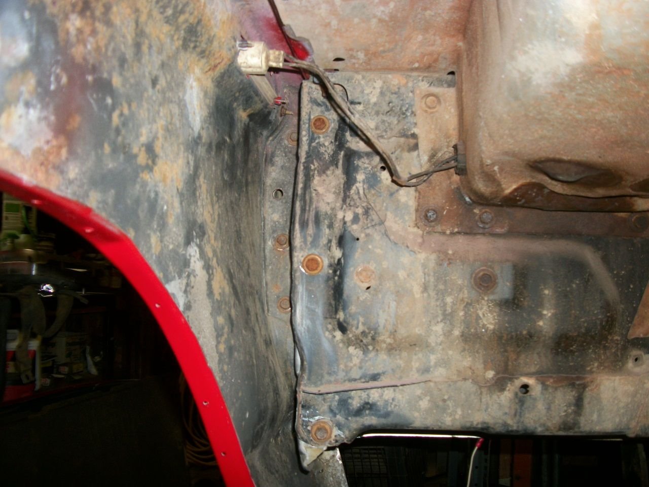

Front fender: Front of fender trim, the nut is hard to easily access with the fender and or outer grill shell installed. Its fwd of the side marker light, but you should be able to get in there with the plastic liner removed or the headlight bezel removed, look for an access hole. See pics. With door open, look for nut on end of fender trim, 3 plastic tabs.
Door: Open door, easy access to each end stud nut and then 3 plastic clips in the middle. Remove nuts, pop off trim.
Bed: Stud with nut back by side marker, remove tail light lens to access the nut. Fwd end of trim (stud/nut?) look way up inside of bed skin for nut. 3 or 4 plastic clips??

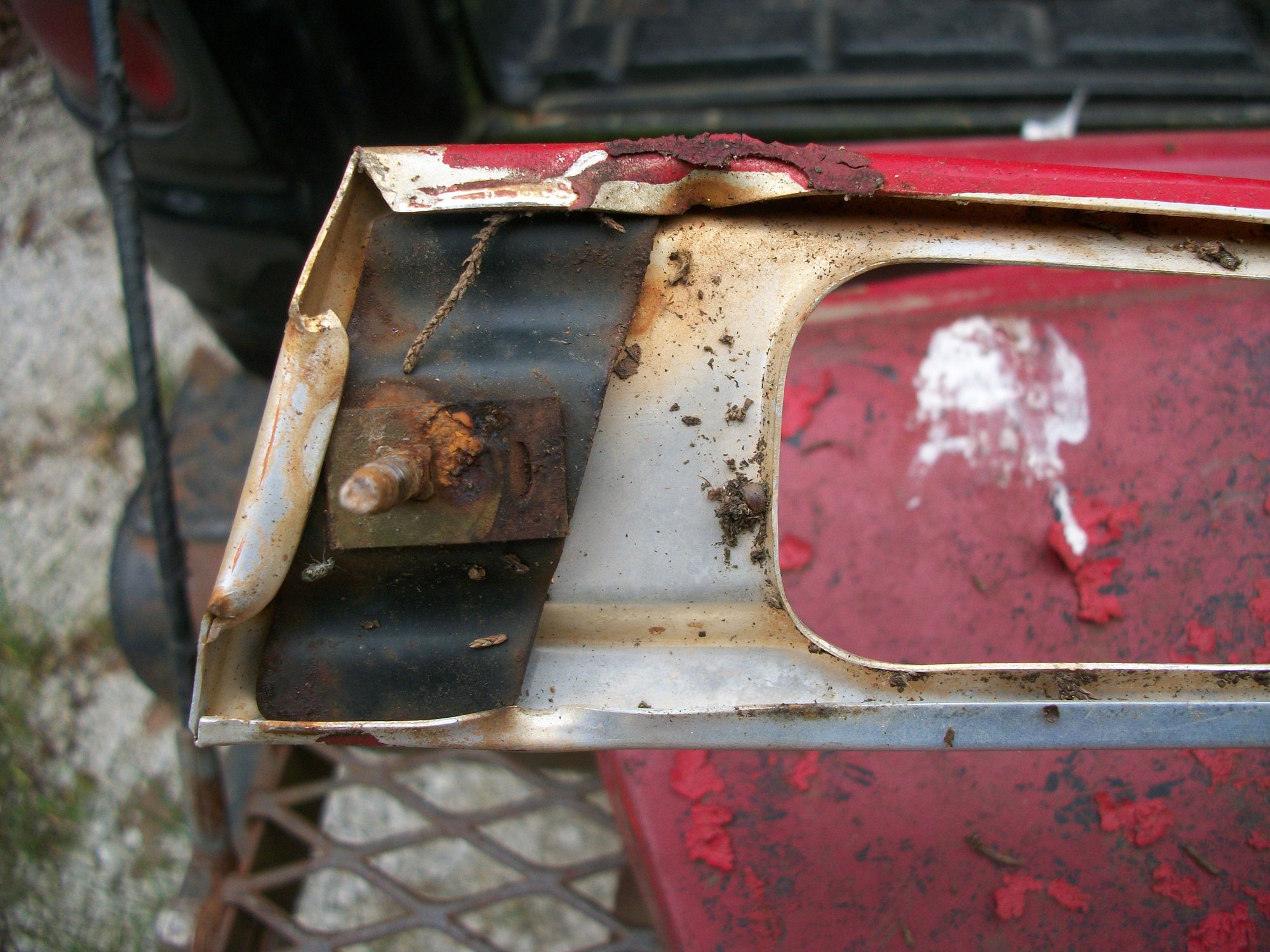

The stud is held in the trim by a flat tab rotating lock into place type set up. Sorry I have de-trimmed more fenders and doors than beds.
