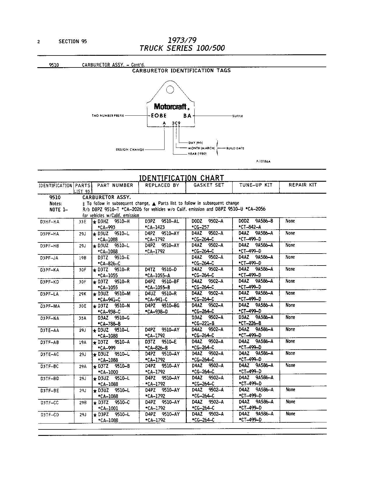

hey all, my 79 needs carb rebuilt. 351m auto 2bl motorcraft carb, how can i id it? i need to buy kit, thanx pine

hey all, my 79 needs carb rebuilt. 351M C6 2150 series 2V Motorcraft carb, how can i id it? i need to buy kit, thanx pine
1975/79: There are quite a few different Motorcraft 2150 carbs and kits.
Carb ID tag located on the top of the air horn (see pic below), post a pic of it or type the info.
If it's missing (as usual by now), where was the truck sold new?
