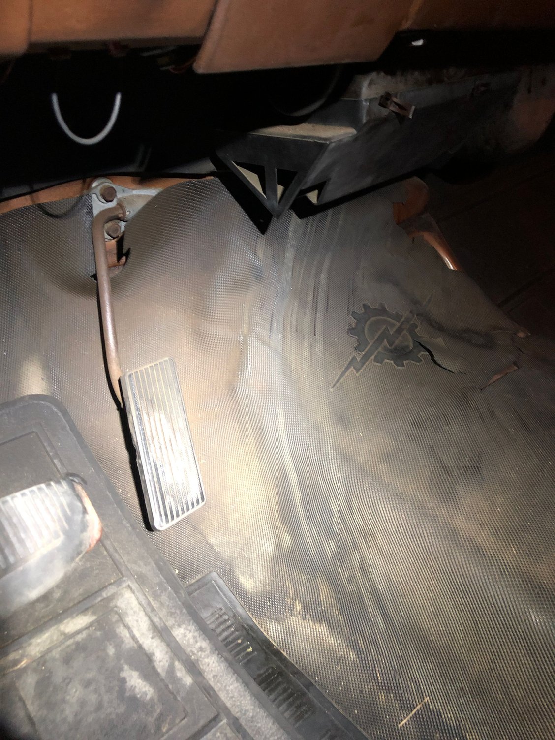

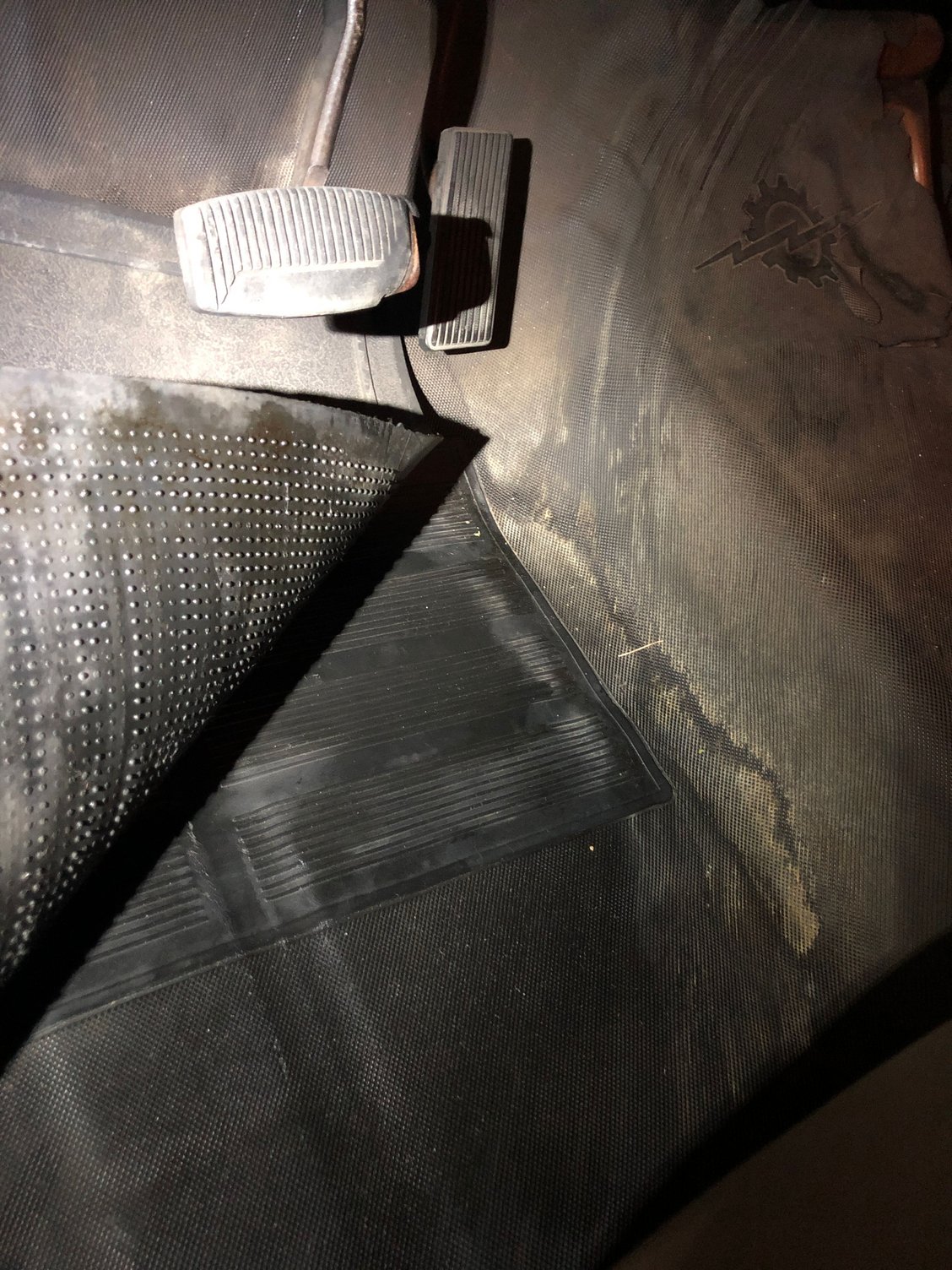

Hey Guys,
I am new to the forum and just started getting into the truck. My mechanical knowledge is subpar but youtube and forums like this will hopefully help improve on that. I took my 73 f100 for a spin today and parked it in the garage so my son and I could change the oil. When I got home to change the oil I noticed this in my cab. It didn't really have a smell. I attached some pictures of where it looks to be coming from but I am not sure.
*pictures in comments*
On a positive note changing the oil with my 7-year-old as my helper was a great dad moment!

Welcome to FTE, as long as it did/does NOT smell like antifreeze/coolant, you are doing ok. Usually a heater core leaks in on the passenger side floor board.

If you have snow or ice on your truck, and a rust hole in your firewall..it could very easily just be melt off. Baby Blue gets it if conditions are just right.
Check your firewall along that general area.

If you're not running antifreeze in your radiator, a leaking heater core will smell kind of like the air in a tire.
With antifreeze, it will smell like pancake syrup...
Also check the pinch weld where the floor-pan/toe-board meets the firewall. There is seam sealer there which can fail.
Another possibility is that the water is coming from the ventilation system. I've seen (online) the plenum tanks develop rust holes.
And if you have AC, it could be condensation overflowing because of a clogged HVAC case drain (tube).
I saw that from another thread on here. I checked again this morning now that my nose is free of oil and grime, I'm pretty sure its antifreeze. I will have to start it up tonight and see if I can locate the leak.
Thanks for the feedback.

Thanks for the advice. Ill take a look tonight. After looking again this morning I'm pretty sure its antifreeze. Last night my nose was not on target. This morning I checked and there was no additional fluid but the residual from yesterday had a sweet smell.

Does the truck have AC? If it's heater only, then it's not too bad of a job to do the heater core. But before getting a new heater core, inspect the heater hoses under the hood. It could be as simple as a hose with a pinhole leak, which just happens to be aimed at a spot where it can get into the cab.

Your cowl drains may be plugged if it doesn't smell like antifreeze or oil.

Run a garden hose turned on into your cowl with the mats off of the floor and look for any drips or rivulets of water.
