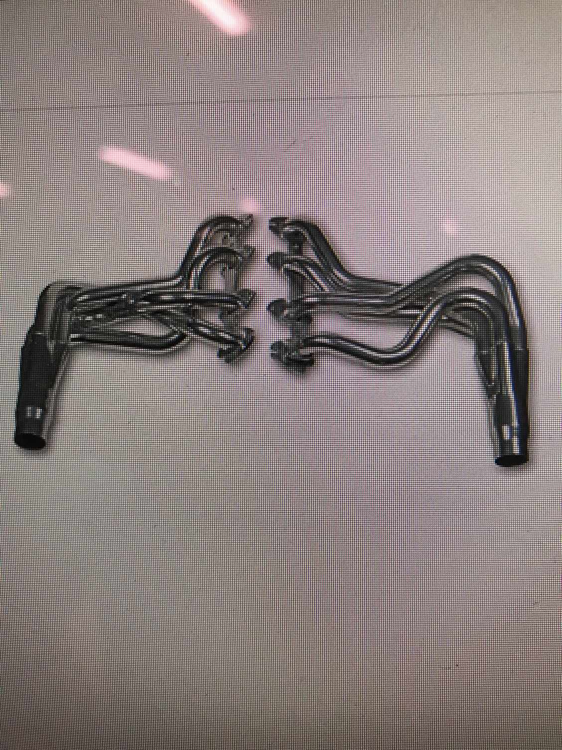

I have a 73 f100 4x4 with a 4 speed manual transmission, I want to buy headers for it but it has a 302 from 1980 swapped into into so I font know how to find out if any headers will fit before I order them. I have a set of long tubes that I bought for my 90 f150 before I sold it but they look like they will hit the clutch linkage. I was told by hedman to try a blockhugger style header because they should be more universal fit. Has anybody had experience with the block hugger style headers?

LMC has log tube Hedmann’s, I’m surprised nobody on here has experience with long tube headers or wouldn’t chime in. I don’t know if you have any access to Motor Trend TV and Engine Masters but they did a dyno test on long tube headers and denting them with hammers until they looked like they were run over by a truck and there was no appreciable power loss on a high horsepower engine that is hooked up to all kinds of sensors. I would compare the headers you have to the ones they say are for your current truck and see where it would work and if you want to try to remove your iron stockers and try to fit them either from up top or from below.

Looking at the ceramic headers for a 1973 4wd and the 1990 ones that are for both 2wd and 4wd, you can see where the right side is really close. The left side of the 1990’s might need some persuasion on the rearmost tube but that might just be along the frame. What do you think? Maybe some pics of your engine bay would help.

the problem that I'm having is that apparently in 73 the 4wd never came with a 302 so there is no headers made specifically for my truck.
https://www.summitracing.com/parts/hed-89356/year/1990/make/ford/model/f-150
those are the headers that I have but my main concern is that its gonna hit the clutch linkage but I'll get some pictures of the engine bay and the headers when I get home from work

I'd go with shorties and find the ones for a 1980 with a 302. If for some reason they don't fit correctly, send them back.
I have long tubes on my 390fe 73 F100 and I can tell you they were a real pain to get in and barely fit.

I have a 73 with a 347 stroker (302 based block) I have some Flowtech Long tube Headers and they will fit just barely with no persuasion necessary. they are 1.75 OD headers but they clear the factory starter and are no where near the shift linkage on my truck. Mine are painted with Heat wrap on them.

Well, a 1-5/8” tube header would give a bit more room. A stroker will need the 1-3/4” headers, plus that wrapping adds to the near clearance.
