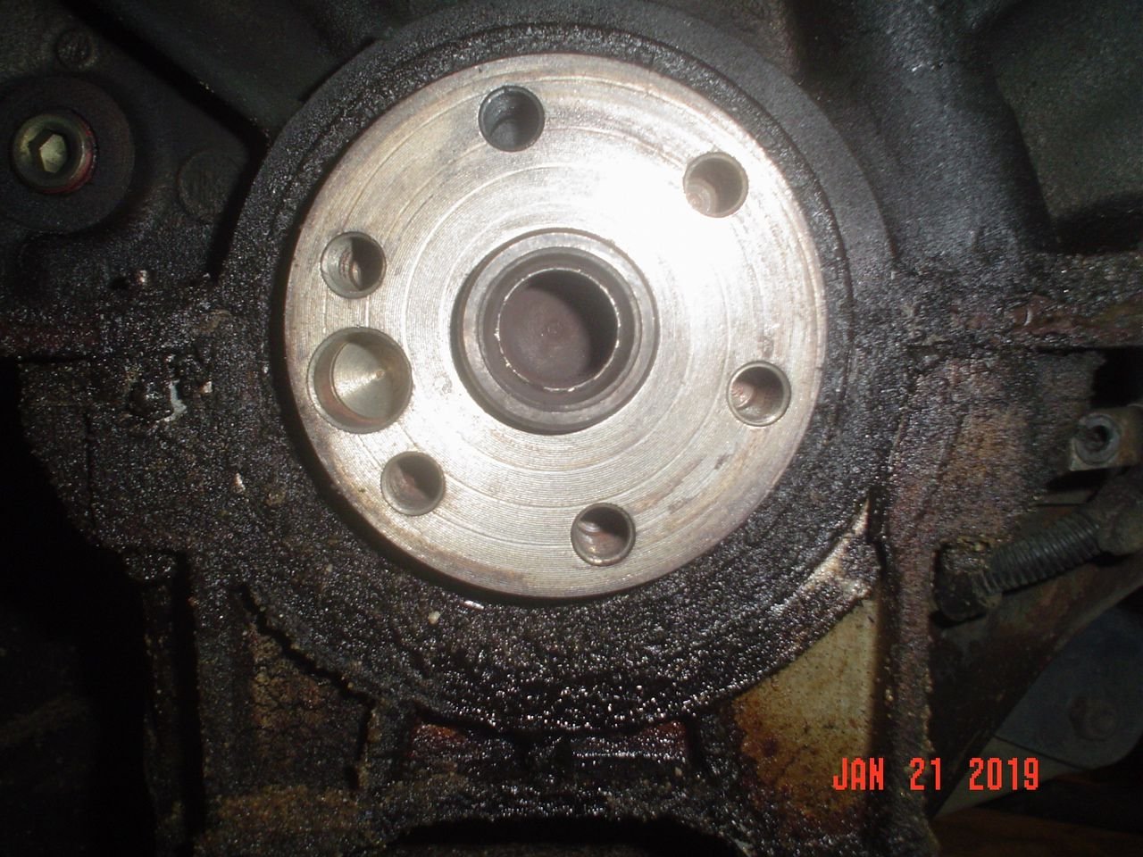

Use a puller like the one shown. There are a couple of different versions of that one. The two rubbers and pin are for the connecting the line to the clutch master cylinder only one is used. The pilot bearing needs to be driven in to the crank shaft with an appropriate driver. Make sure it has grease in it.
