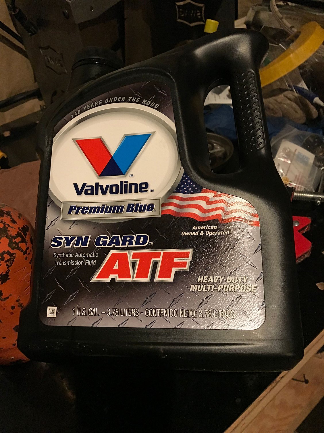

I have an early 99 f350 4x4 with a 4" lift on 35's. This weekend I replaced my steering gear box (old one was sloppy and wondering every where) along with that I replaced the pitman arm, center link and track bar. I drained and flushed my p/s fluid with valvoline synthetic mercon LV ATF.

That’s what I had to do to get my trac bar to line up and that was with a drop bracket, and done that on a few other trucks as well that didn’t hurt any thing. The biggest probem I see is you put the WRONG fluid in it it takes Mercon V, it originally took Mercon, Mercon V superseded Mercon. Mercon V and Mercon LV are not interchangeable. This may not be your problem at the moment but will cause you one eventually.

Thinking the LV fluid took out the pump/internal seals or something along those lines.........make sure to get all the LV fluid out before installing new pump or ya may run into same issue.

Got it up and running! It was the pump. And I refilled with mercon V.
