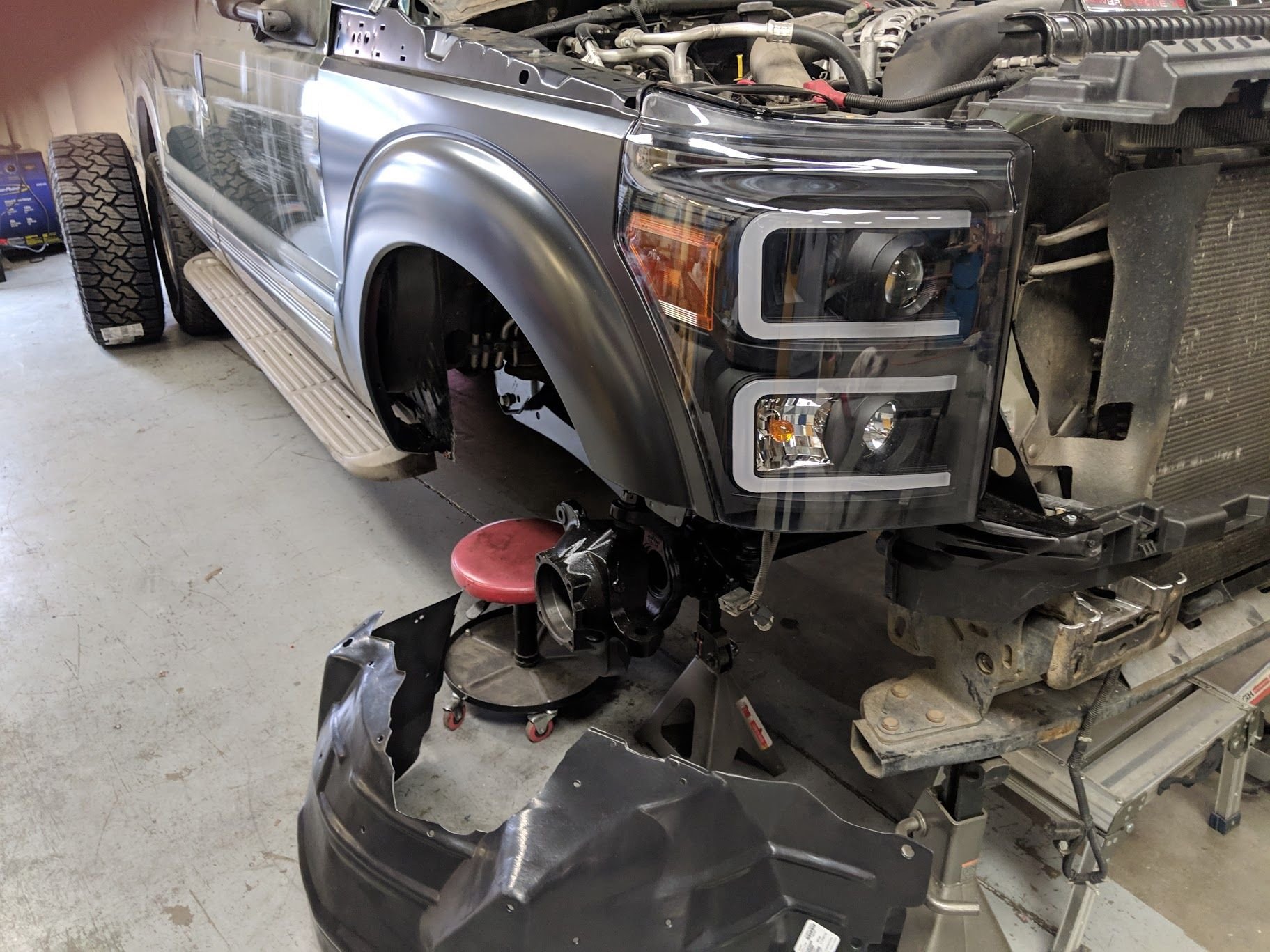

This is the mocked up of the axel. There were some factory holes, some needed to be drilled. Also here is the first pic of the fender mocked up.
Later in the build I opted for an ARB locker in the front diff. There is a TON of opinions on frnt/rear/both. I had the front out and decided it was the time to do it if I was going to. Fronts are, I am told and believe, harder to drop and install than rears.
The headlights are mocked in here. You can see the tire, 35-12.5-18 Nitto.
A huge problem that was unknown at this point was the windshield wipers. The McNasty kit was not so clear with instruction or part numbers. It has since been resolved.
Here is the kit mocked up and confusing as hell.
Either way it was 8 hours of trial and error, on my dime, to set it up. Ill try to find finish pics.
Free air compressor with the air locker and a 2 gallon air tank.
The from bumper is my design. I wanted an open winch. Got the Smitty 17.5. Not the best of the best but well made and reasonable for what you get, Cost $625 +/-.
The 2" reciver in the clamp is for a.......
Chair! This is a swivel boat seat. There are actually 2, one on each side. I plan to surf-fish, bow-hunt and duct tape my enemies like Mad Max.
Here is the front end complete with steering and sway installed.
This is a power fold Rock Country mirror. No option on fold and extend so i opted for the fold.
It works with the adjustment switches.
Here is the front bumper supports from the under carriage.
Here ai the wiper cowl done.
Another Chair shot....
If you look out the door on the picture you will see the doors for the passenger side. I had to buy another Ex and hack it apart for the body panels.
So this is where I am at today May 8th, 2019. Hoping to get all the wiring done and drop to body in 2 weeks.
Here is the paint and logo-
Since the truck was green prior I am opting for a military flat green wrap. I think this will match up good.
The logo is all me. Hate it or not, i am rolling my faith and county.
Did the books and paid the bills, Total investment to complete, $40K. I have seen less trucks for more and never for truck for less.
I will upload the finish pics in 3-4 weeks. Shabbat Shalom.

i can see the pics, not sure why you all can't. Ill try again.
The wiper mod
Mock up
Frr compressor with every ARB air locker....
Air tank
Air locker
Wi9nch mock up
Winch mock up 2
Winch mock up 3
Front of new bumper
Front end ready for tires and alignment
35-12.5-18
35" Nitto 5 tires for $1562.50 delivered. No tax or shipping.
80%
My chair
Chair 2
Chair 3
Bumper bracing!
Mnn I dig this!
Complete
My friends and family think I am crazy, F$#K it, attack me, I am prepared for you.
