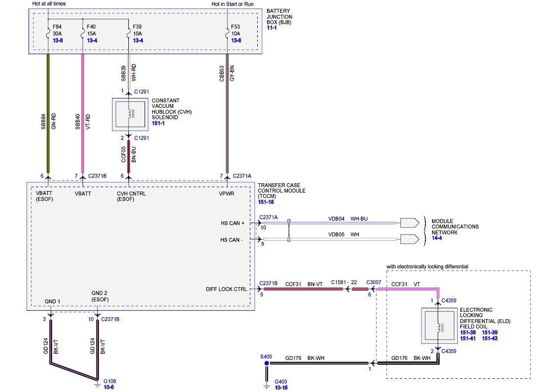

2015 F250 with locking e-diff. Locked e-diff disengages above 25mph in 2x4 or 4x4 hi, as it should.
I have a problem I'm trying to diagnose, and it would really help if the e-diff stayed locked above 25mph in 2x4 mode. I know there are kits you can buy, but I'd just like to setup something temporary. Cutting/splicing wires is fine, and even having to hook something to a external 12v power source would be fine.
Any diagrams of the e-diff available?
How might one do this?

This might help.

Thanks!!! That looks easy! Measure voltage at C3007, then unhook from controller and fake that voltage. Awesome!

12V direct will lock it up. It's a modulated voltage through the pcm, but there's guys that have swapped them into older axles and run off constant 12V without issue. One guy was even monitoring the temp to see if constant 12V would overheat the solenoid and it wasn't an issue.
