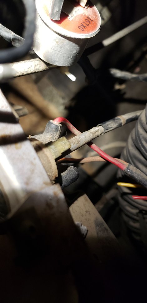

Here is the back of the switch

First thing to check are fuses. There aren't many.

I think those two wires are the heater feed, but the switch will need 12v in order to have an output. Do you have 12v anywhere with the key on?

One thing to look at generally is the large electrical pin block connectors through the firewall, these will be corroded all to hell unless somebody has given them some special attention. Try a brass bore brush and kerosene.

I think the wire is 14ga Brown and comes from the fuse block. Unless someone used it for something else it should be not far away.
