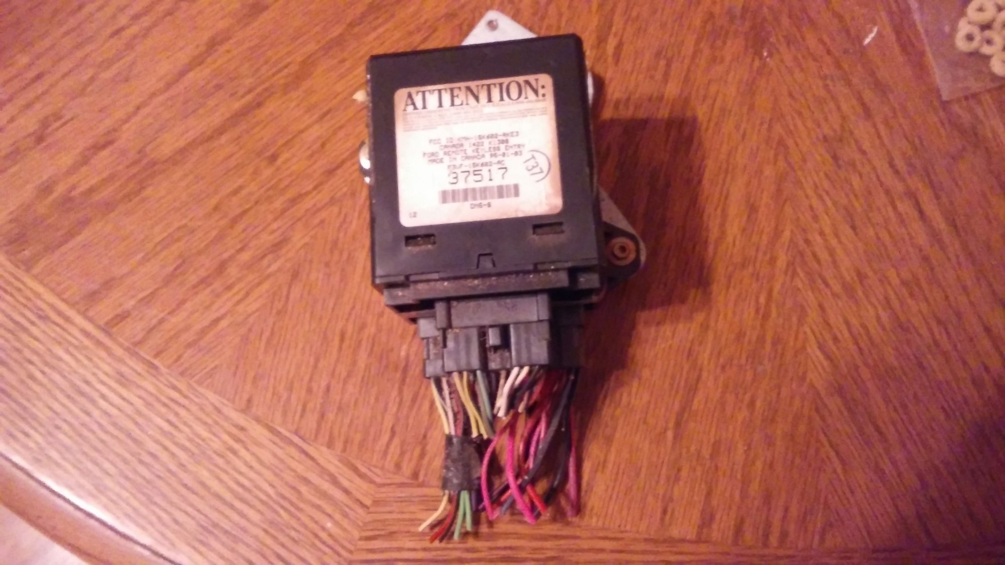

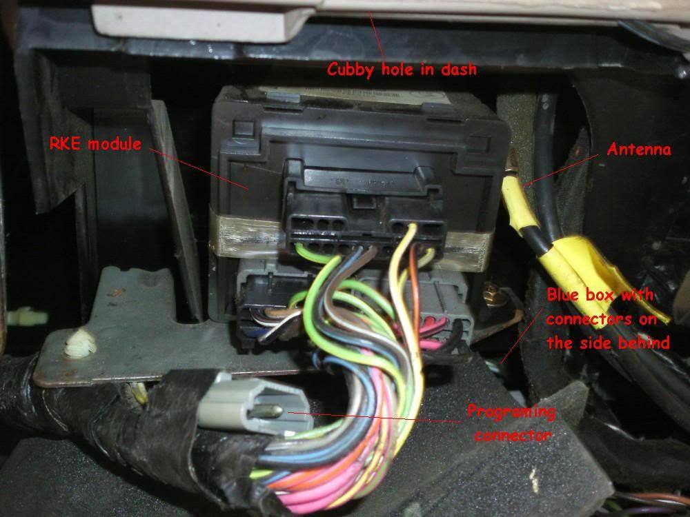

From my experience the factory OBS RKE (remote keyless entry) module is under the dash behind the pocket under the steering wheel.
This is what the module looks like removed from the truck.
This is what it looks like from under the dash. You short out the 2 pins in the gray connector with a screwdriver or paperclip to put the truck into fob learning mode.

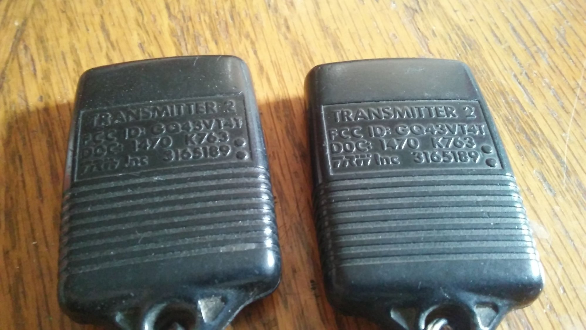

This lists all the old fobs. Type 2 and 3 work with our trucks. Our remotes have the words printed on them, LOCK, UNLOCK, PANIC, TRUNK.
This list all the programing methods for the older fobs.
Our remotes have the words printed on them instead of symbols. LOCK UNLOCK PANIC TRUNK. You can use a car remote with the trunk buttons on trucks. But pushing the trunk button does nothing.
FCC ID GQ43VT4T 3165189
The turning the key to on 5 or 6 times is for the newer trucks and cars and does not work with this generation of module.
