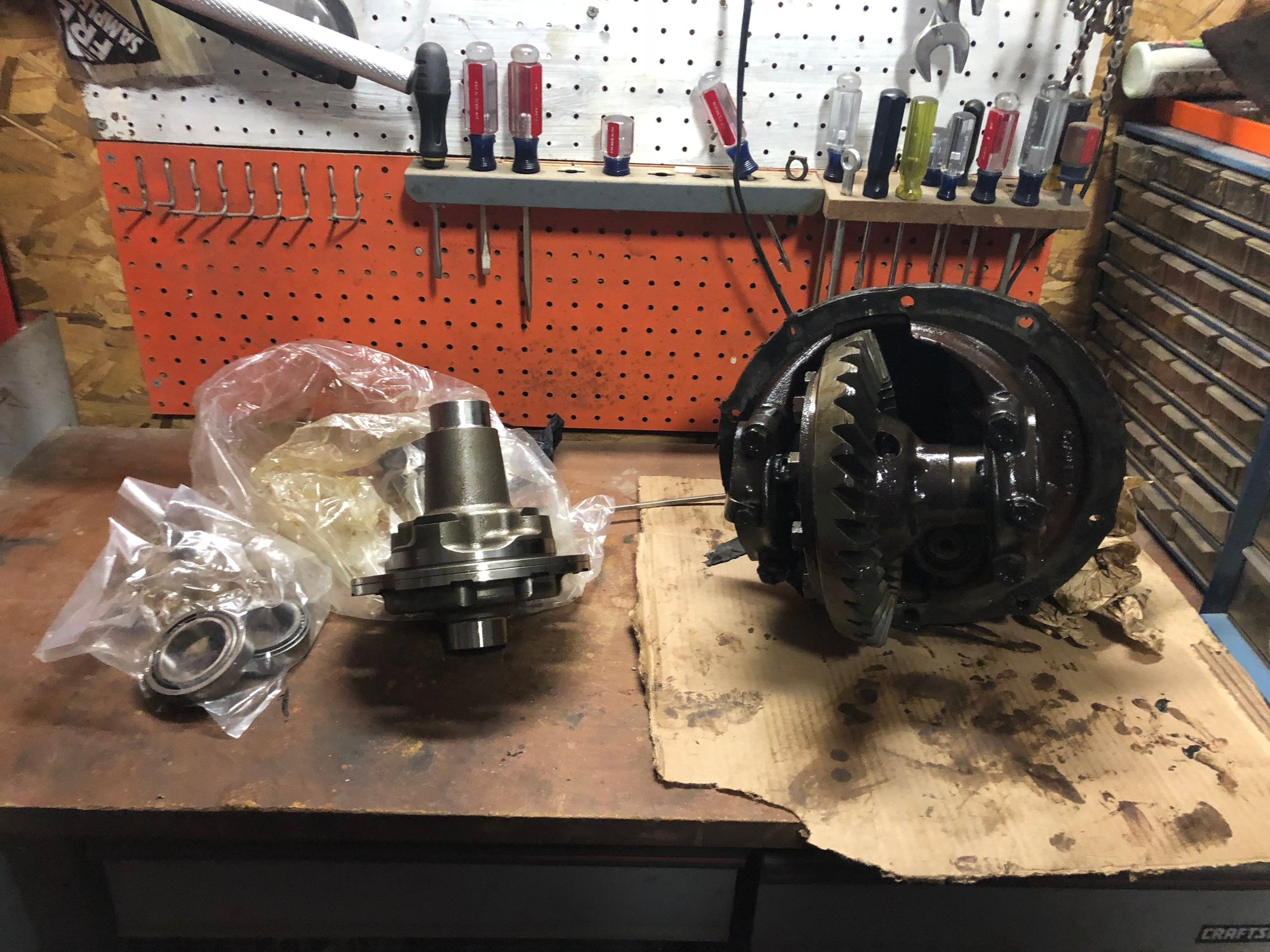

I just pulled the 3rd member out of my 79 F150 4x4 with a 31 spline 9” rear end and there seems to be zero slop or backlash between the ring and pinion. Does anyone know what the factory specs are? It’s a stock, open differential with 140k miles that has never been cracked open from what I can tell aside from replacing the wheel bearings and pinion seal within the last two months.
The reason for pulling the 3rd member is to put in a Detroit truetrac using the factory ring and pinion (3.50 ratio) and new bearings. I had plans of buying or borrowing a dial indicator to set it back up to the correct black lash but now I’m not sure what to do.

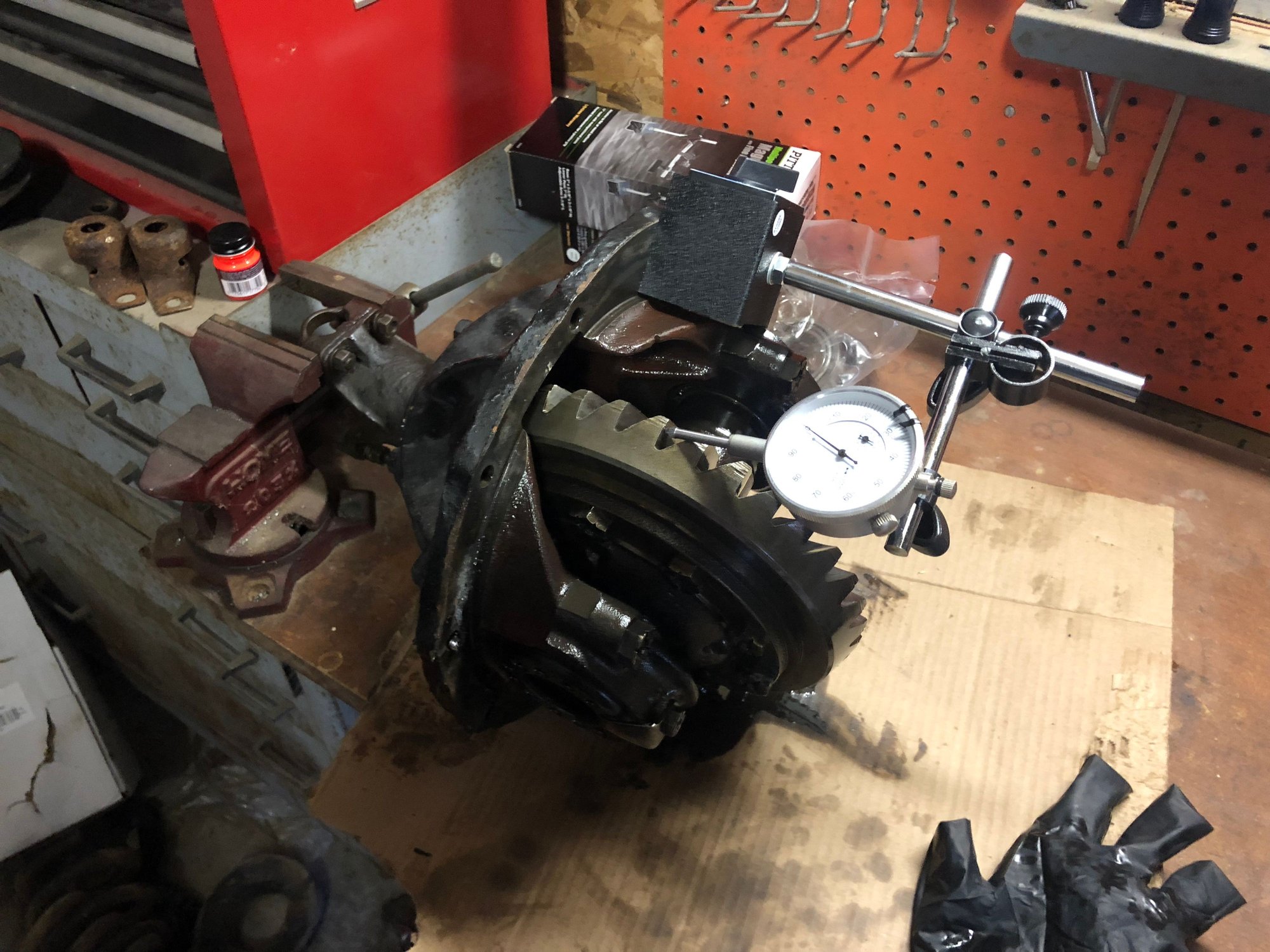

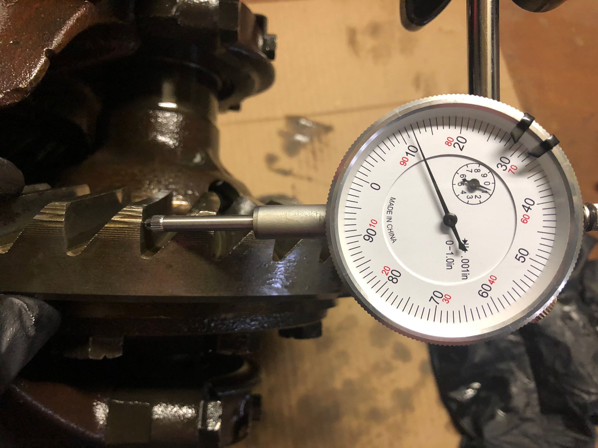

I must have jumped the gun posting that. Now that the cold oil has drained a little more I can hear and feel the backlash. A $28 harbor freight magnetic dial indicator confirms .012 backlash
Any tips for how would I go about setting the bearing preload?

i have a vice grip with flexible wand that locks down to hold an indicator.
I saw that at Harbor Freight but it looked like it would be kind of flimsy. I bought the indicator and magnetic base separate and it ended up being a couple dollars cheaper than the vice grip setup
