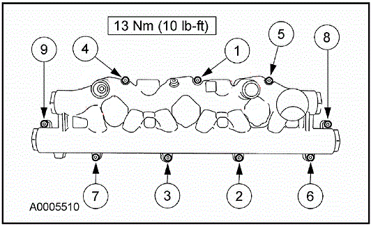

There is a Tool with rubber on the center part that expands when you tighten it up. First time that happened to me I fiddled around for an hour trying to make something similar out of stuff laying around the garage. In the end, I just pulled the oil rail off the head. That gives you access to the top of the tube and you can pull it out with a pair of needle nose ViceGrips.

Pulling the oil rail there are no gaskets. Upon reassembling blow out the small holes that the screws go into. Also torque in the proper sequence and torque spec.

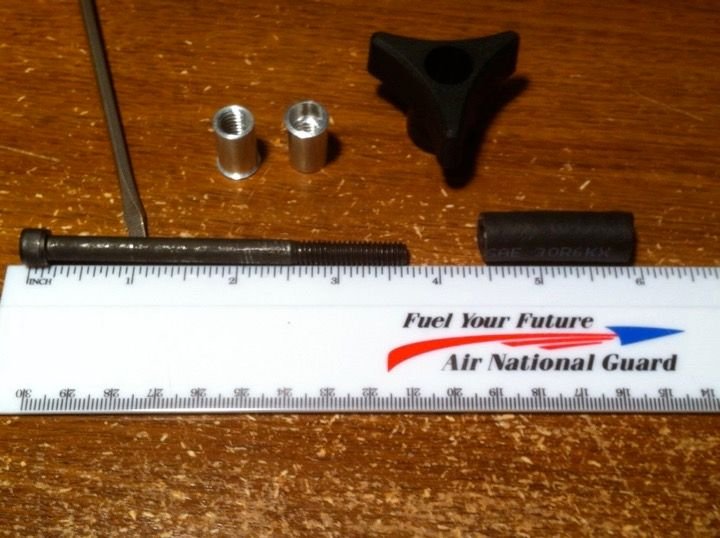

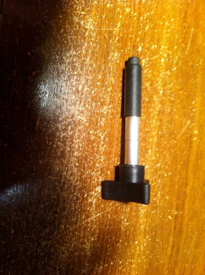

Here is my afordable DIY lower stand pipe puller parts. The two aluminum parts are just some aluminum spacers.
You can make them out of anything that works. I just happened to have some non-flange rivnuts on hand. Pipe would work also.

Sean, would you mind share how that tool would work? If I recall correctly, it's pretty slipper and smooth inside.

You stick it down into the tube and tighten the thumb screw and pull. The 1.5" section of rubber hose expands outwards and will grab the
inside of the tube and you just pull. If I did my math correctly that hose will give you almost 2 sq/in of contact area and add to that the force
and you have a bit of gripping power to pull it out. I have never had one I could not remove with that tool. The new truck was a bit stuck
and the tool worked nicely. The reason I picked aluminum as the spacer is it won't scratch the steel of the stand pipe. You want a rubber
hose that is very snug on the 1/4 #20 cap screw so it does not slide around. I used some heavy wall gas fuel line. Should be 3/8" I think.
When you go shopping look for some that are not the shiny slick rubber.

Thanks Sean. I wasn't thinking about that. Very clever.

Lost less money than the one from Rotunda Tools or OTC Tools.
$15.00 Vs over $200.
