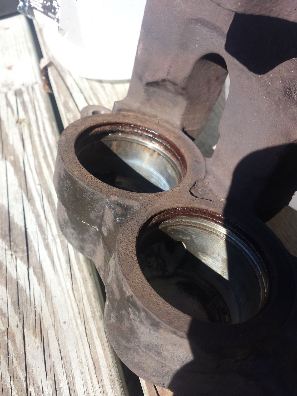

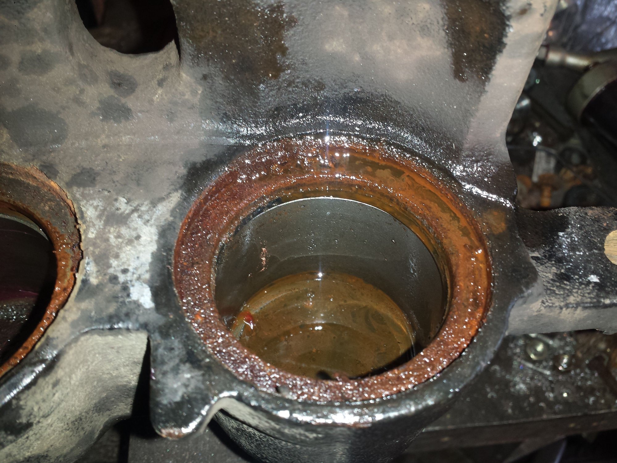

The only way I get calipers to last is blow them apart and cover everything inside the boots with a caliper silicone ceramic grease. I rebuilt my own more than 2 years ago and have done multiple trucks and an Excursion with no issues.
The problem I find is moisture rusts the cast retaining lip for the seal. That rust grows around the piston and ends up jamming in up. You can see here the rusted lip. I get rebuild kits and clean that rust off with a round wire wheel from Harbor Freight that I put in a drill. Comes out clean then I coat everything in the grease and assemble.

Pete's silicone grease solution is probably as good as my RTV. If you look at his first image the bottom caliper bore has the rust propagating past the dust boot groove. The top caliper bore has the rust propagating down farther, into the o-ring seal. Wire brushing is effective, removing the oxides without abrading more metal away. Most of the rebuilding houses use some type of media blast to clean the bores and the exterior. That opens the bore slightly compared to factory. When I do mine I'm going to try to use Evapo-rust, but the ideal method would be electrolysis. That's way too expensive for a rebuilder. Using an acid (Vinegar, Citrus, Phosphoric, etc) I would be too worried about hydrogen embrittlement of the casting, but those might be fine. I just don't want to play lab rat and slit a caliper across it's bridge.

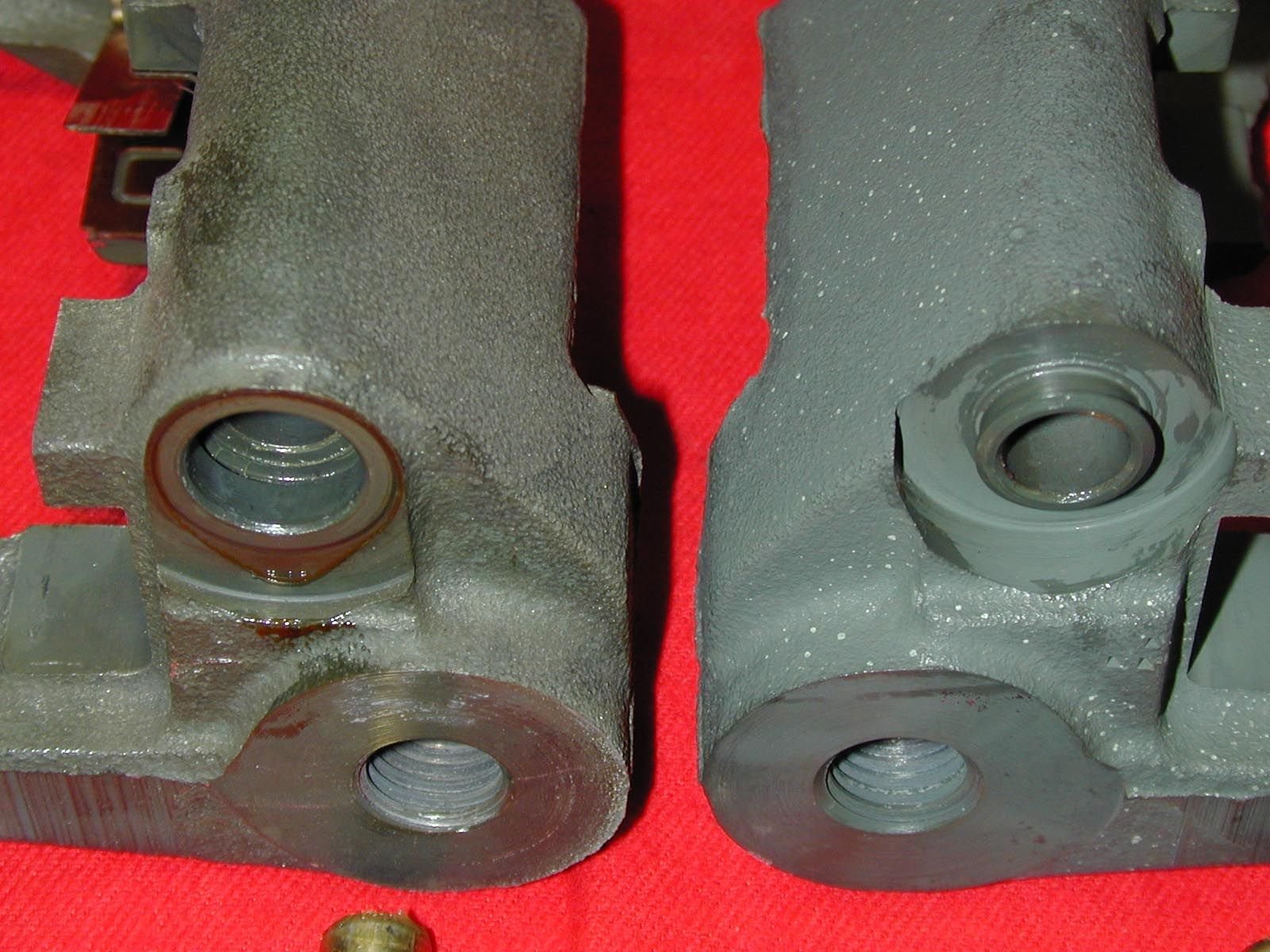

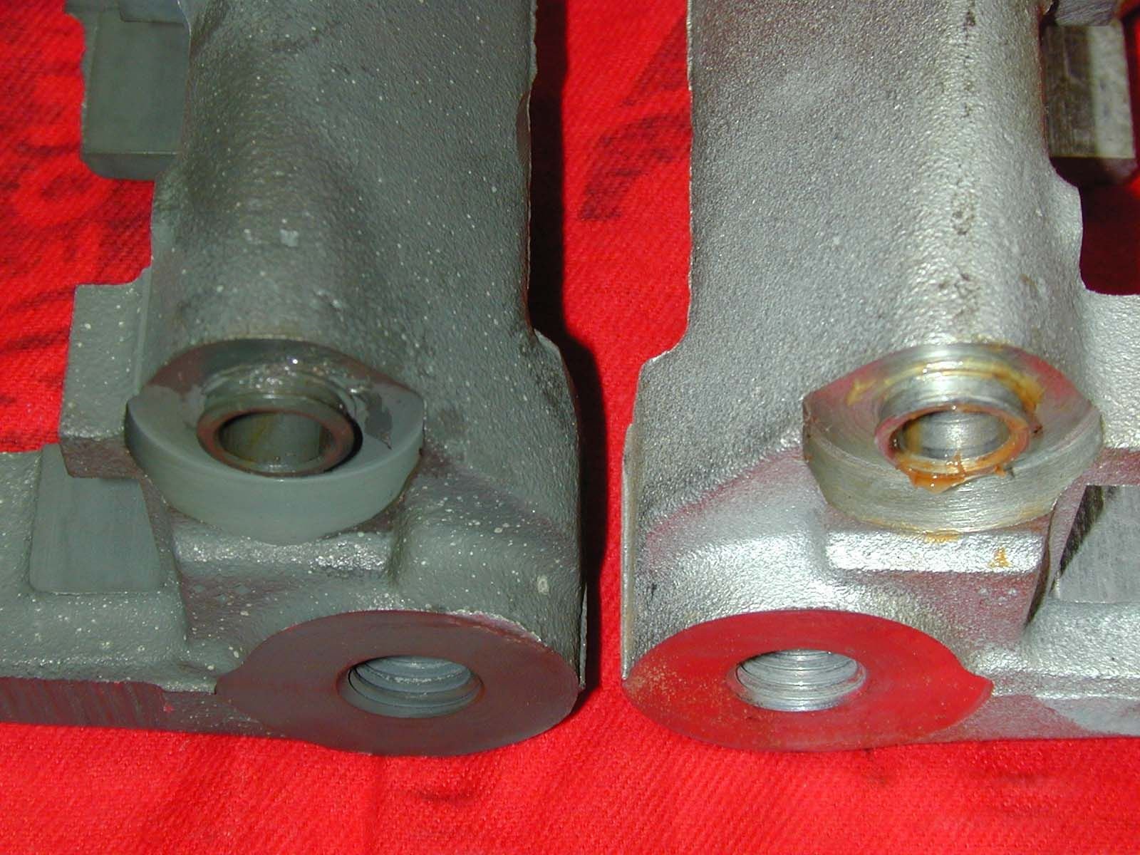

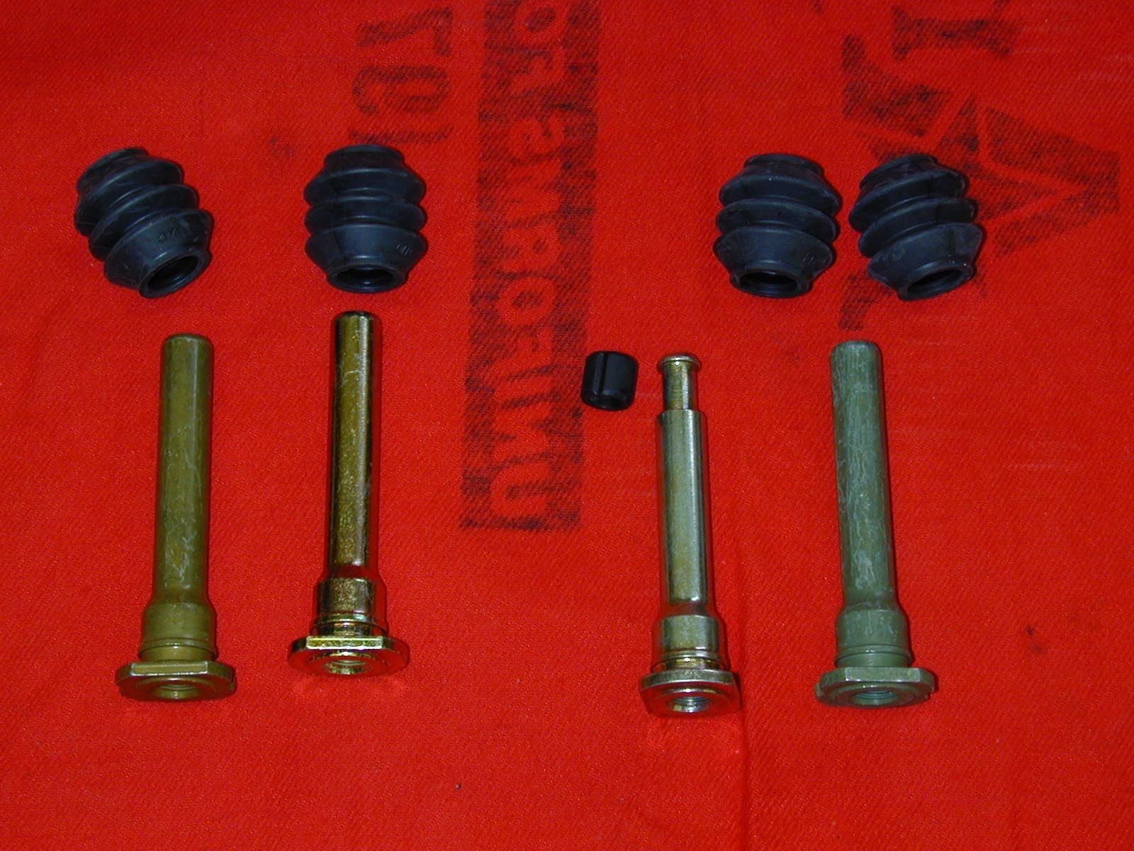

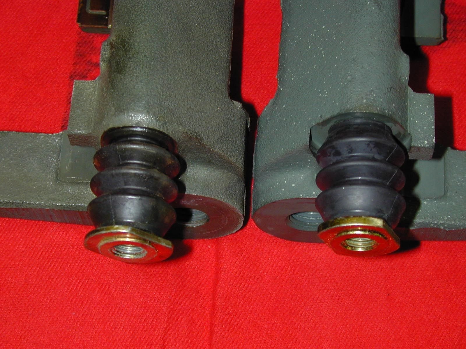

50k on my 2001 F-250 and 205k on my 2003 F-350, never had a slide pin frozen. I check them every oil change, and had one with resistance due to the stupid rubber bushing on the front lower pin, but never had frozen slide pins.
There were a number of us that thought the change from the Generation 1 front slide design to the Gen 2 was a bad mistake, and even worse with the Gen 3 added rubber bushing. Gen 1 was as the rear pins are, an internal boot fitting groove which tightened with any rusting, while the Gen 2 boot seal was exterior. The 2003 still has a Gen 2 with the removal of the bushing, but I have a set of the brackets from the Gen 1 series as someday backups.
Picture 2 also shows the original olive colored anti-oxidation coating extended into the bores of the brackets. Aftermarket replacements or rebuilds I don't believe do.
I just never had the problems many of you have had, but I detail out the rebuilding, mostly the way mastersativa laid out. Again, I talked about this 15-16 years ago on TDS. The caliper design is not bad, it suffers from some of the aftermarket mistakes in pads, pins and boots. And the lack of understanding that once the bracket bore rusts, cleaning it, wire brushing it, and abrading it does not stop the oxidation progression, it just removes the crust on top of the pits. You either need new virgin brackets or chemically treat the bore to etch out the process.
If one of my slide boots get damaged, it get replaced with an Akebono boot which hopefully is what ford provides in the service kits.
While the P131 Superduty was the first entry into the USA market by Akebono, if you look at the Honda Accord Akebono front caliper you see it's the same deign team, just a little brother.
Added pic, 2001? Olive colored anti-corrosion caliper vs 2003 Yellow anti-corrosion coating, pin design change Gen 2 in both.
