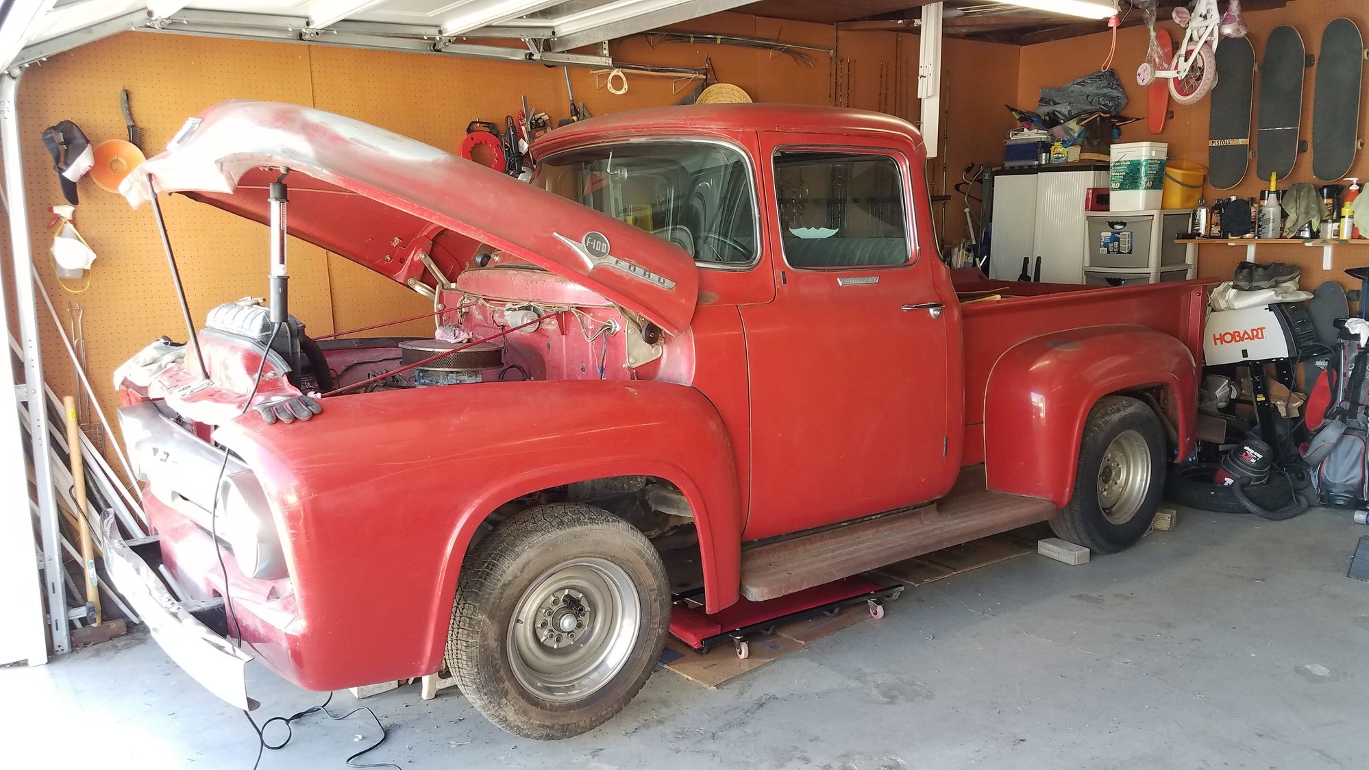

Here is a picture of my 56. I've been a member for awhile with several F100's that have since been sold, but this one is for keeps.

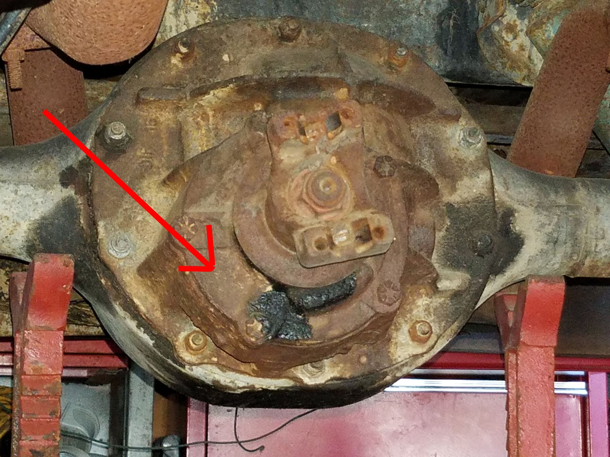

That is a leak from your pinion seal.

Pic: 4035 is the 3rd member gasket, 4676 is the pinion seal, 4669 is the drive pinion bearing retainer O-ring.
1st pic in post #1: Pinion seal is leaking.
