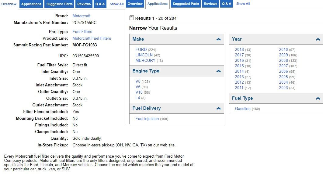

The hardest part of this is releasing the front "quick disconnect". It's having the right tool. I have a collection of those tools. All of them were inexpensive, and just did not fit & work well. All of my cheap disconnect tools were from auto parts stores, amazon, ebay, et cetera. So I struggled for hours, for a job which should have taken minutes. Does anyone know what the part number is to the tool from Ford? Does Ford make a tool which actually works?
