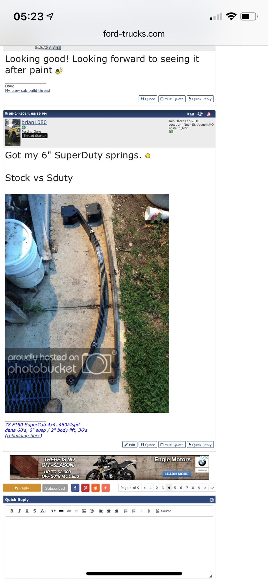

From my build thread:

I didn’t make any new brackets, I think all I had to do was drill out the holes and grind the bushings a bit to fit. These are 4-6” but it should be the same for any lift
also, they were cheap. Think I got them from jcwhitney or maybe rock auto for less than $300/pr
