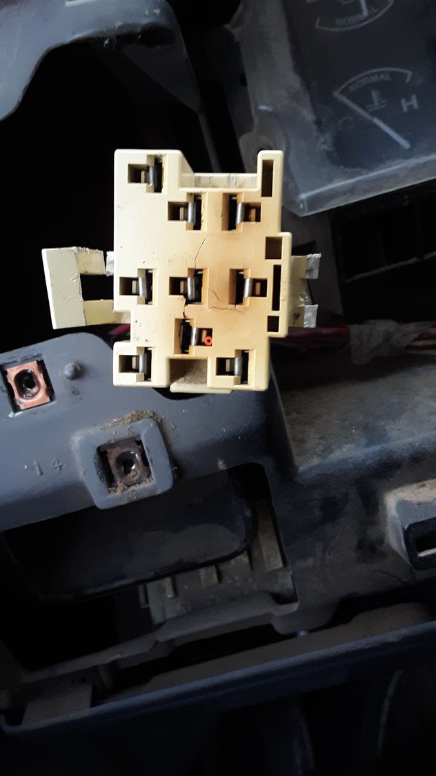

Sorry for the lengthy response time I usually get off after dark but today I had time to take a look. I found the issue fuse #4 hiding up there cant believe I missed it but here's a picture of the plug anyway. Is the condition of the plug something to worry about?

Glad you found the problem. The harness has gotten a little warm, but I don't think it is any thing to worry about.

the head lights run full current from battery to dash switch and back to lights (simple version)
the heat from the current will discolor the connector over time
