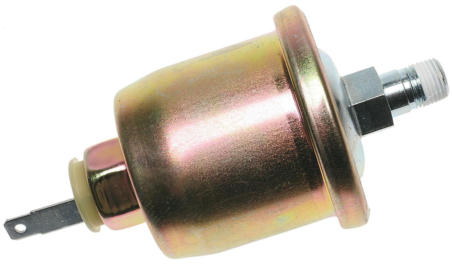

Something is wrong with that sending unit. If you have a oil light, you should have a little guy with one stud coming out, not a big fat can looking thing. The little one is a switch which is what you want, it should read zero ohms to the engine metal with the engine off. This will light the light when the key is turned on. The wire going to the sending unit is actually the ground for the light. When the switch see's anything above 5lbs pressure, it ungrounds the wire and turns the light off.
That 63 reading is suspicious, I am wondering if you have the gauge sending unit instead of the switch you need for the light. The sending unit for the gauge will read a continuos variable ohms to ground that moves the needle back and forth up and down the scale on the gauge.

Here is a oil pressure switch you should be using.

You should not be using one of these.
