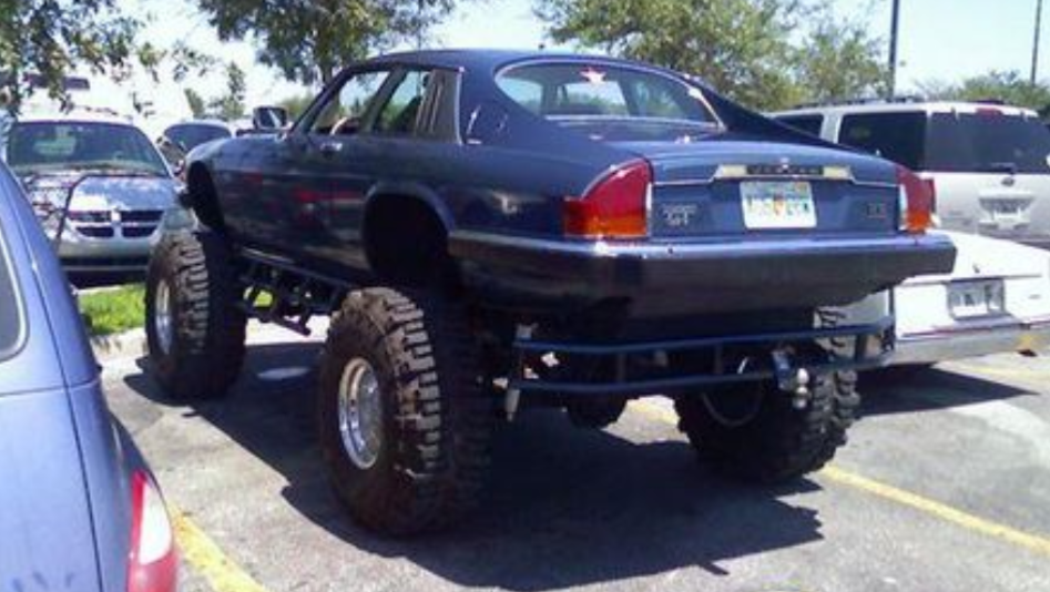

A Ford truck cab on a Ford truck chassis, how hard could it be?
Sounds totally doable, much easier than putting a Jaguar on a 4X4 chassis for instance.
