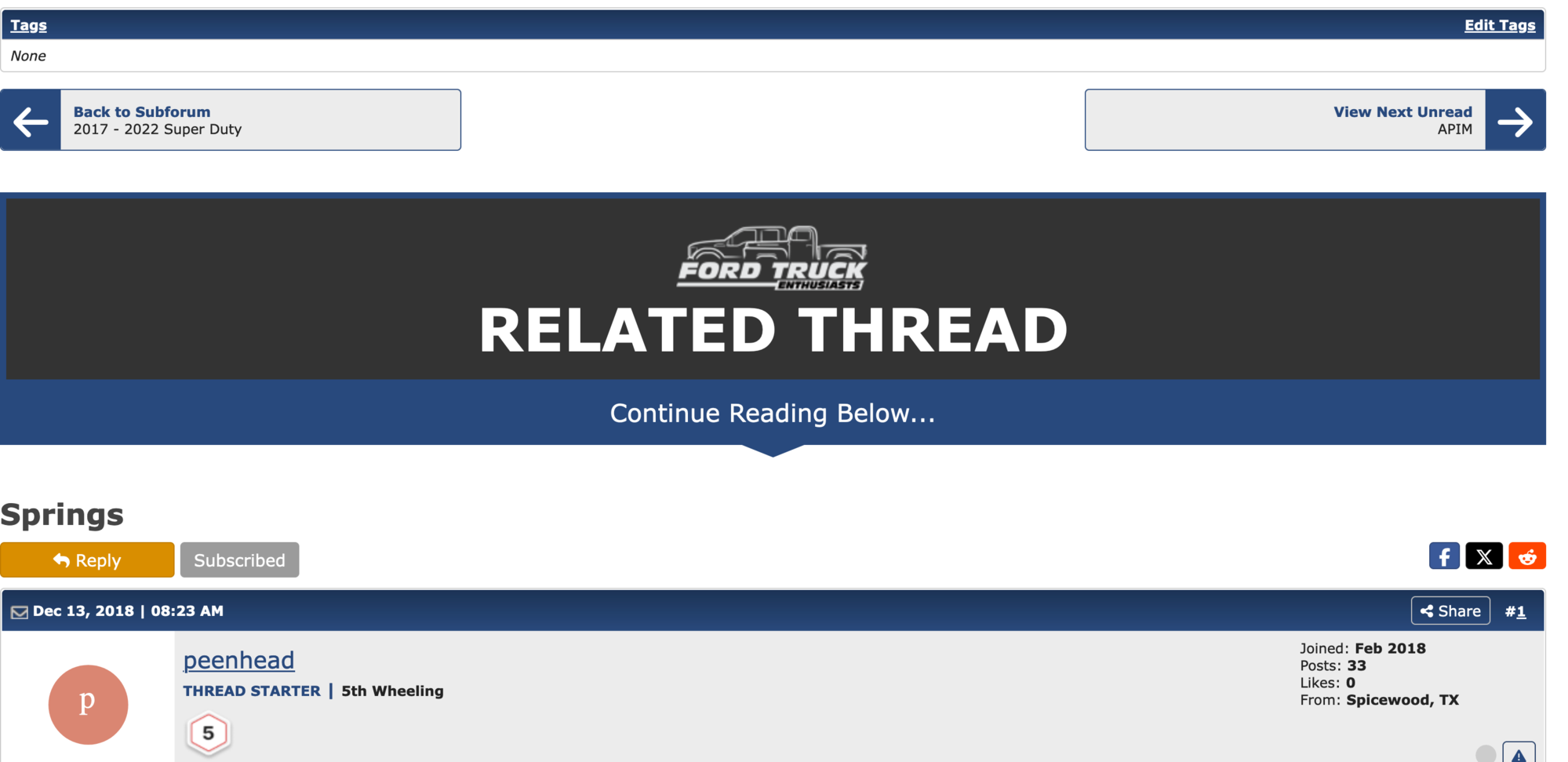

Ahhhhh....scrolling too far past the post I was replying to, to end up in a "Related Thread" area. Crazy how these forums work these days.
yep, I’ve done that. I absolutely hate this “feature”. It’s even worse on mobile

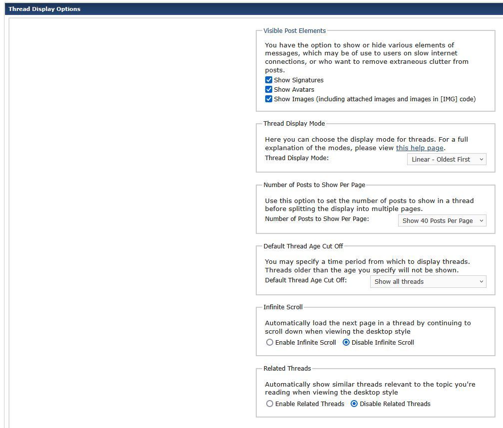

You can turn off infinite scroll and related threads from the user control panel...
