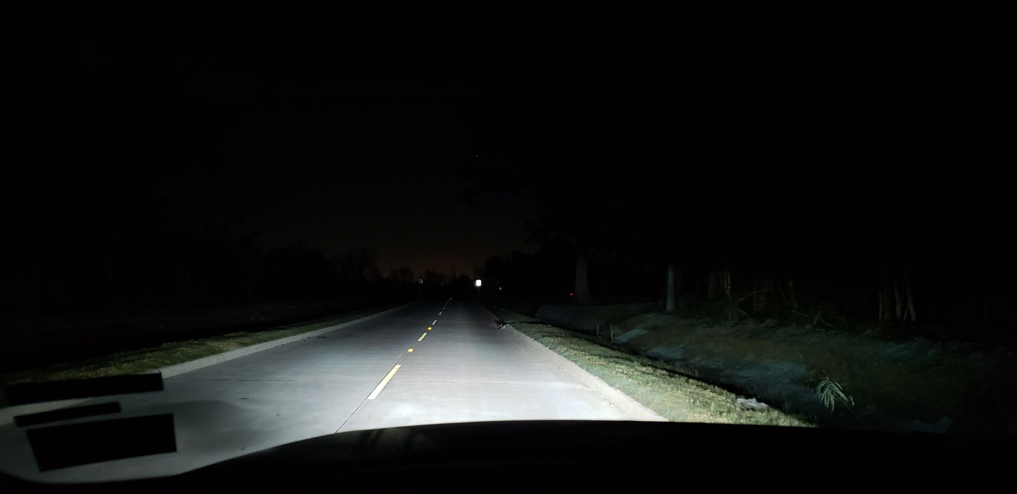

That's nice they look better, but what I and most care about is how do they work. How is the light cut off on the low beam projector? How much light is thrown down range on high beam? Inquiring minds want to know.
They are adjustable both vertical and horizontal. Now these aren't your thousand dollar+ factory projectors either. I have not had anyone ever flash me. When I get the time I can take some pictures. These are 100x better than the old non adjustable projectors I had. Only con with these is the only way to adjust them is with them unbolted from your truck. So it is a lot of trial and error.

Thanks for the feedback, and as always pictures of both high and low beam dispersion would be greatly appreciated.

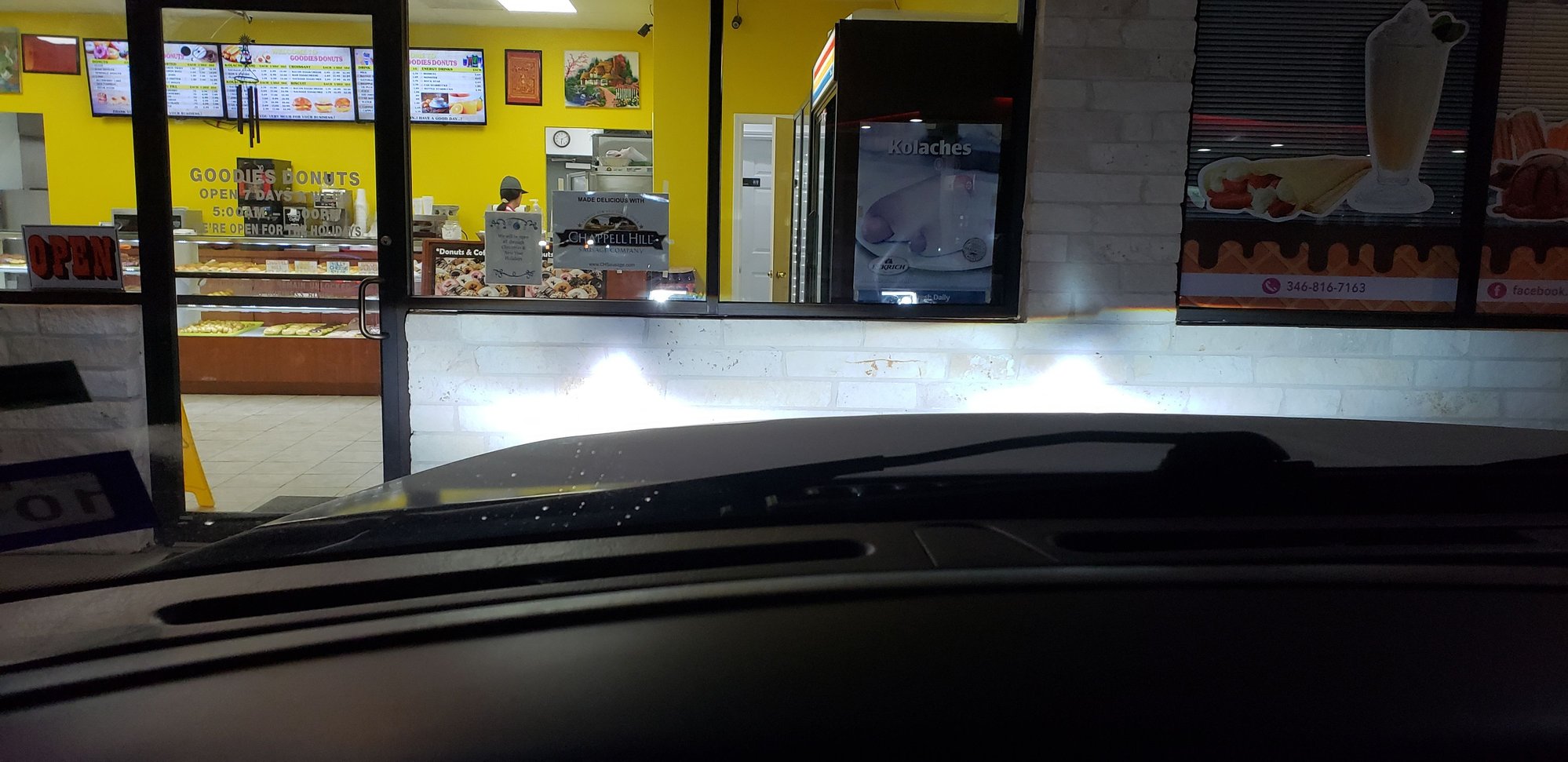

So I took some pictures. I may need to lower them some though

Thanks for the pics. It looks like they have a decent cutoff, but is a little hard to tell over the hood and with all the back light from the store. Is the wall low beams?
Yes low beams only Brights light up the sky lol.

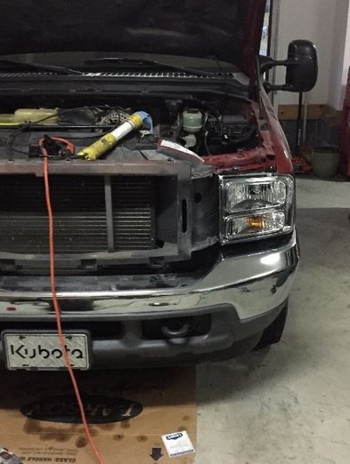

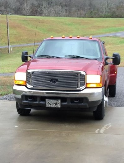

I went the 05-07 headlight route. I ordered the headlamps and adapter pigtail form Riff Raff. All went well and was relatively easy to do with the instructions from Riff Raff.
You will not be able to go back to the OEM style headlamps as you cut almost all of the old mounting surfaces off to get the one piece 05-07 headlamp in.
I havent had a chance to tell much about the brightness yet, but have to be brighter than my old fogged/water condensation filled 01 headlamps.
Pics or it didnt happen:
Old OEM 01 Headlamps OFF
Old Headlamps ON
In Process and a slot for the air filter snorkle
New 05-07 Headlamps installed
New Headlamps ON
