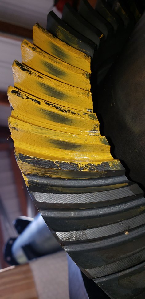

8.8 pattern
Am I too close to the toe ?

I'd run it.

Same. Go with it. It's next to perfect.

X3, run it, should be ok.

Looks pretty dam good

Pattern does look good, did you measure the backlash?

Better than I can usually do!
