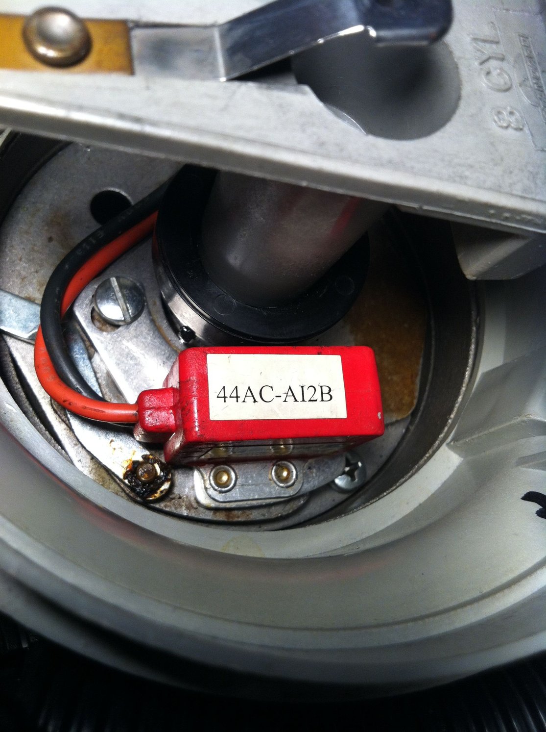

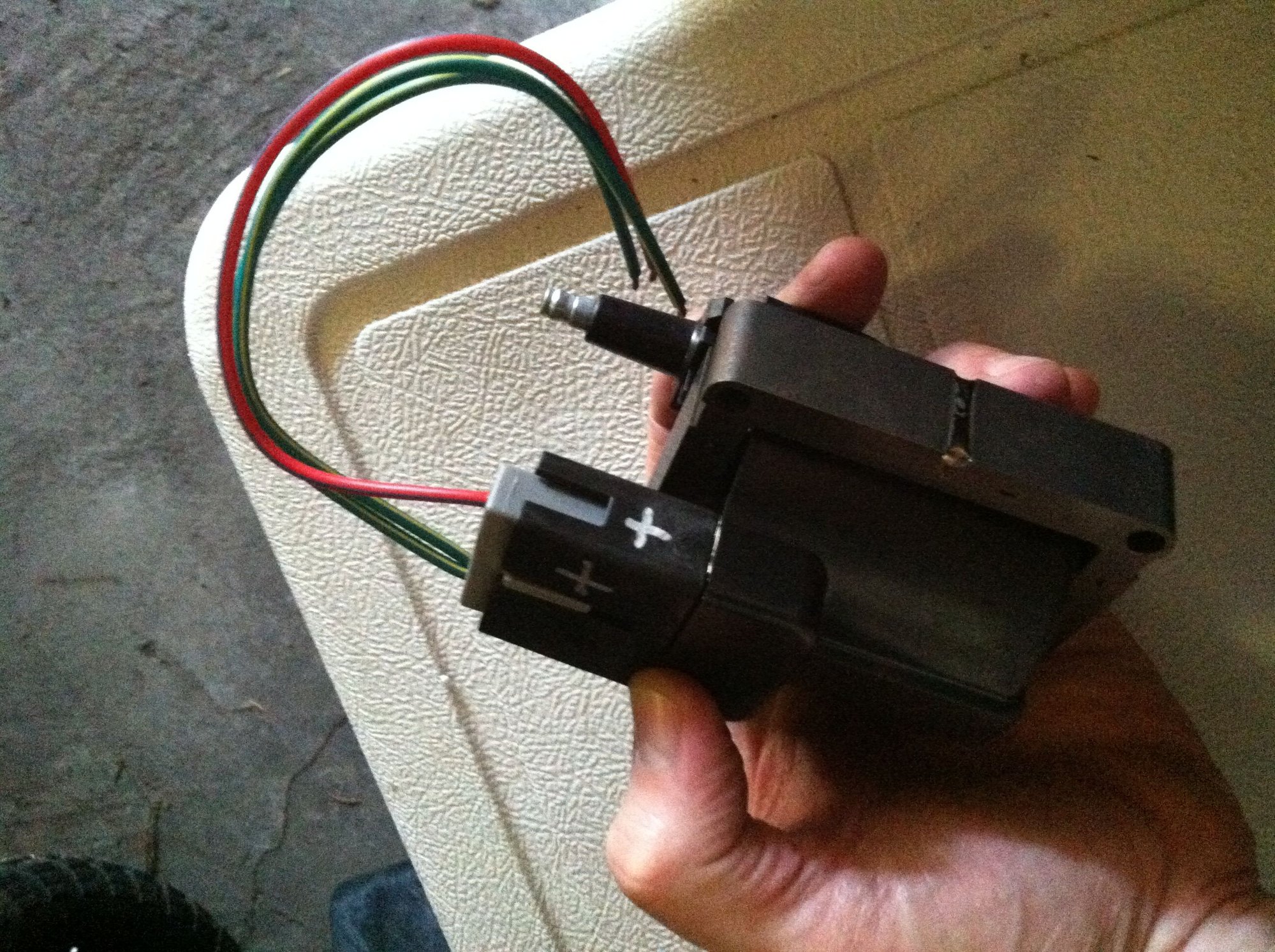

If you want a modern, no-oil, new coil that is fairly easy to mount, you might look into the mustang E-coil modification. It may give you a little better starting, lean-run*, and lower emissions. (Mine was actually cheaper than the N*PA best-quality stock coil, but that may be a local thing.)
Pertronix Ignitor II in my truck. I also did the 'big cap' mod. Could widen the gap, but I stay conservative at .038".
E-coil from a Mustang, BWD p-Series E92P. You need a new coil wire, with appropriate ends.
Mounted on the power steering bracket, with a piece of aluminum U-channel. I made a little connection box, mounted near the original coil location. (not shown)
Mounted on the power steering bracket, with a piece of aluminum U-channel. I left it long for some other computer stuff I'd like to include. There are through-bolts, about #10 in size to hold it to the channel. It is cooler here, and the aluminum may have some heat-sink effect.
I may post some updated pictures of the rest of the installation later. This gives you the gist of the modification. You can run full juice to the coil for racing.
*Comment: Try not to run your engine lean, but it happens during those 'bog' events others describe, so sometimes it will light those lean fires, and avoid washing the walls of oil.
