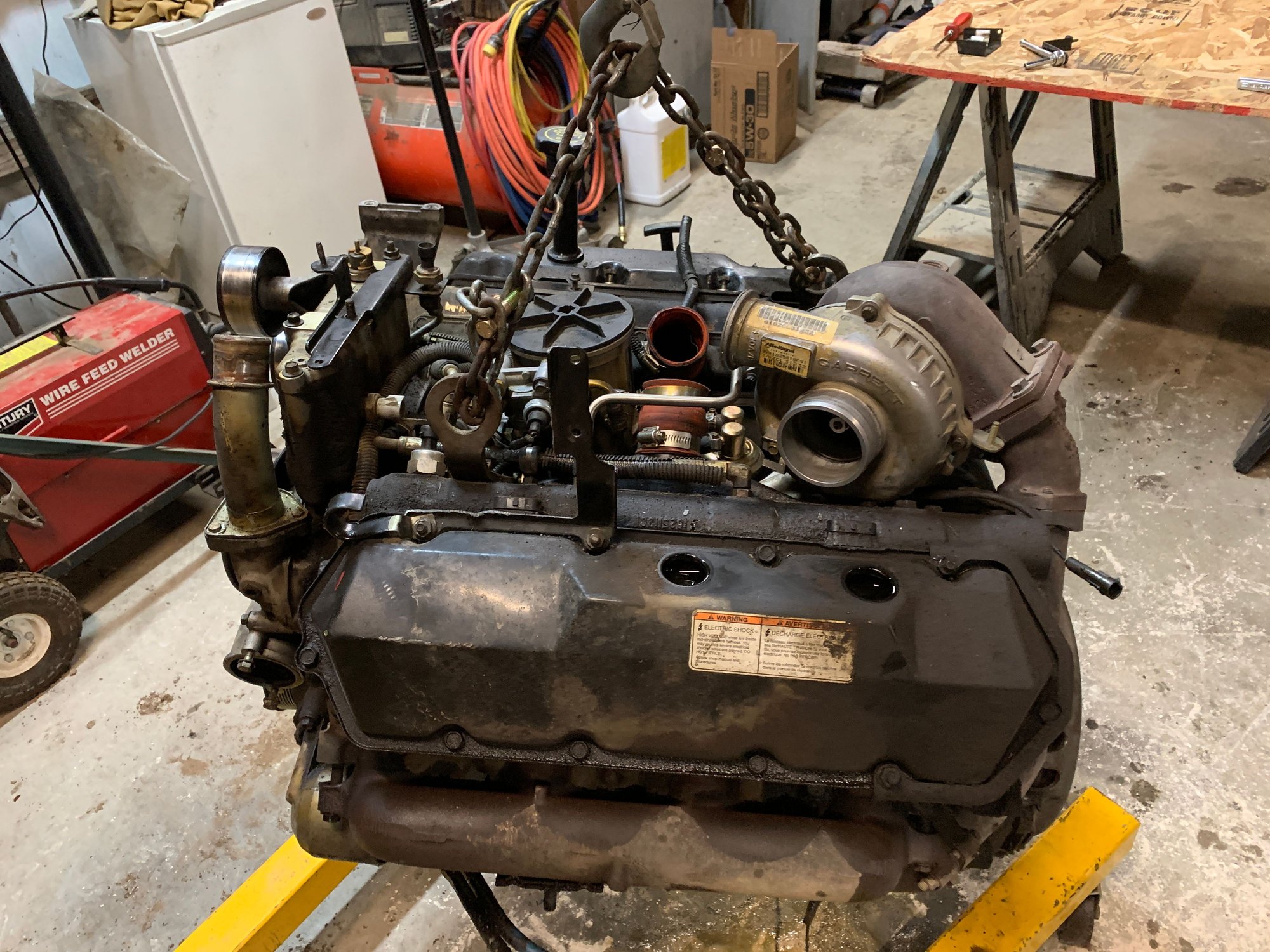

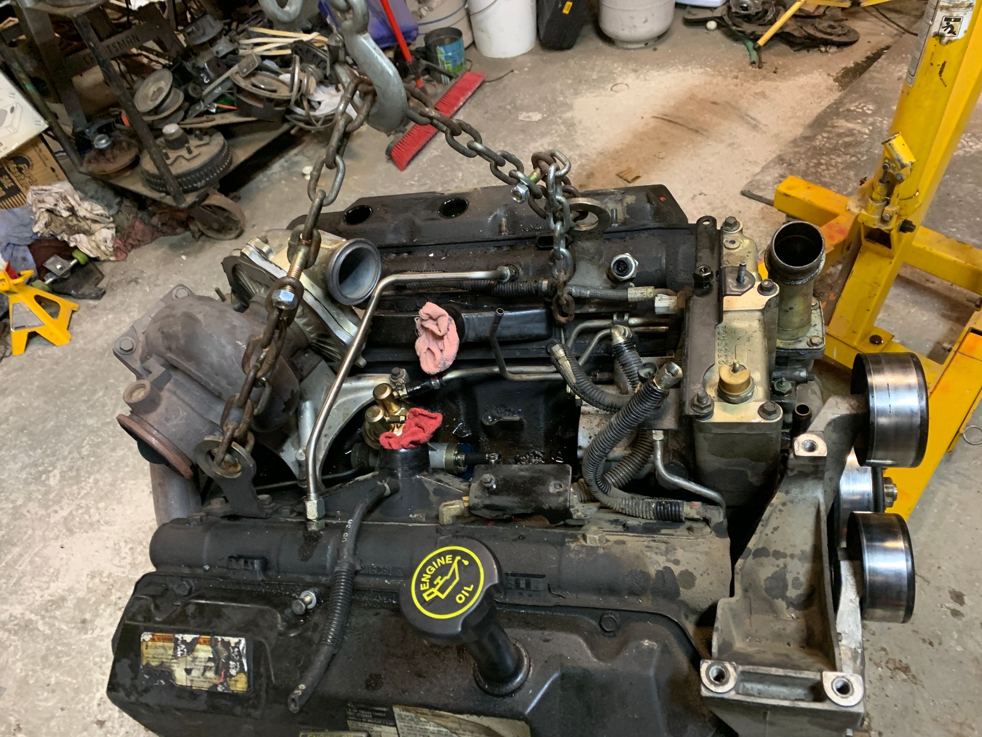

Well just an update on my project, got the engine out and all steam cleaned off. It was a lot greaser than I thought. Gor the oil cooler reseals and put back on. High pressure oil pump all resealed and the hpop reservoir o ring changed and the oump reinstalled. All new oil rail o rings and turbo pedistal o rings along with a non ebpv pedistal and I removed the valve out of the exhaust outlet. When i inspected the bearings i found that even though their still in spec they show pretty good wear so their getting replaced befor the pan goes back on with the new gasket and dipstick adapter.

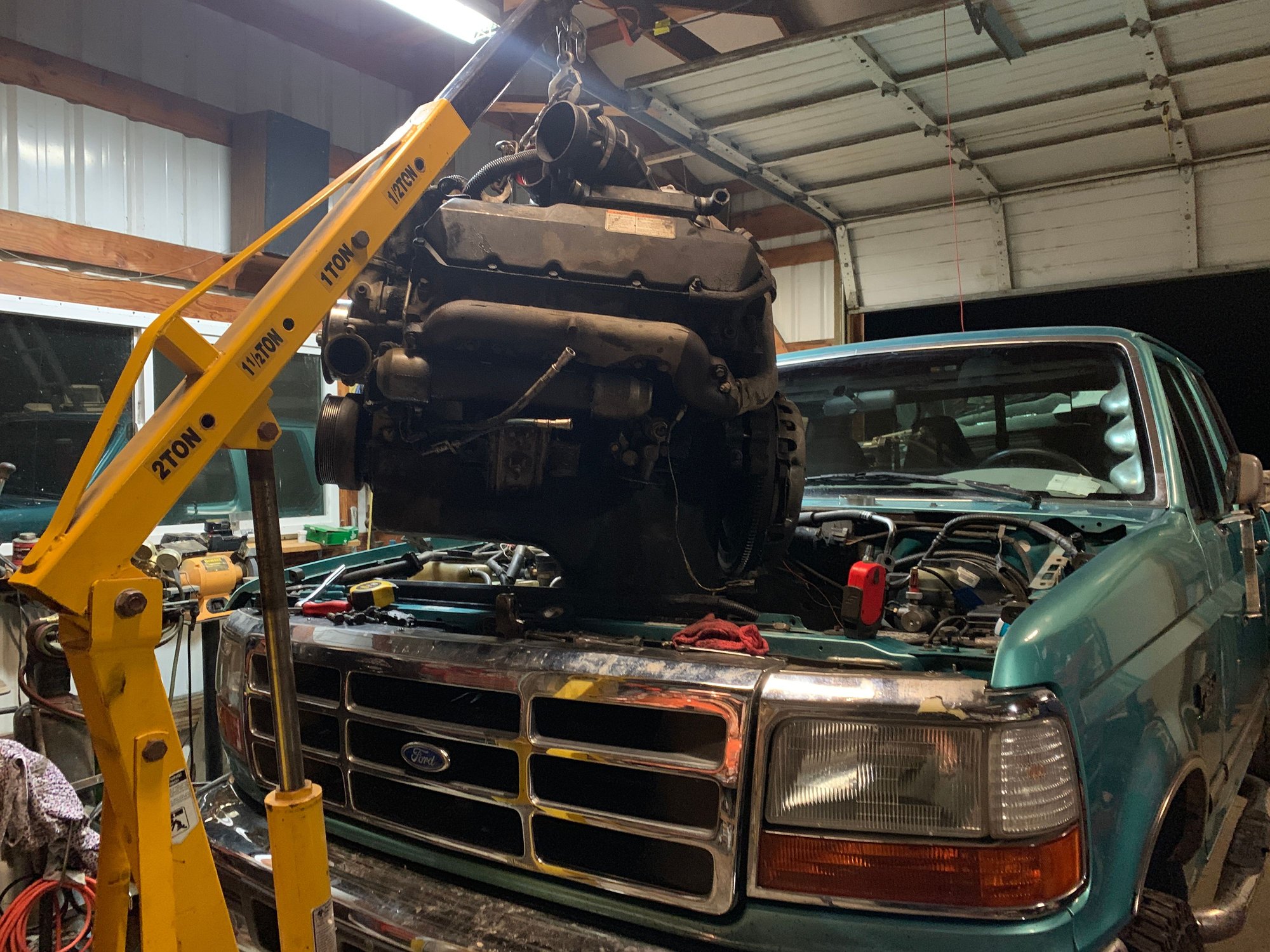

Well engine is back in and running great, ive got one small leak either from the front main seal or the oil pump gasket but either of those are easy. took quite a bit of driving to get the air out of the high pressure oil system about 50 miles over a couple days all together other than that it’s done.
