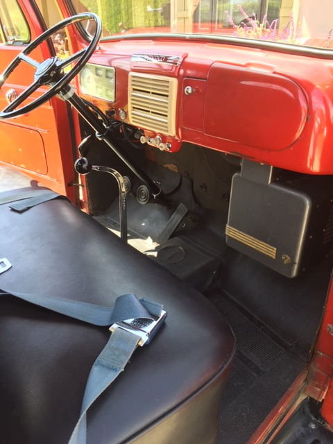

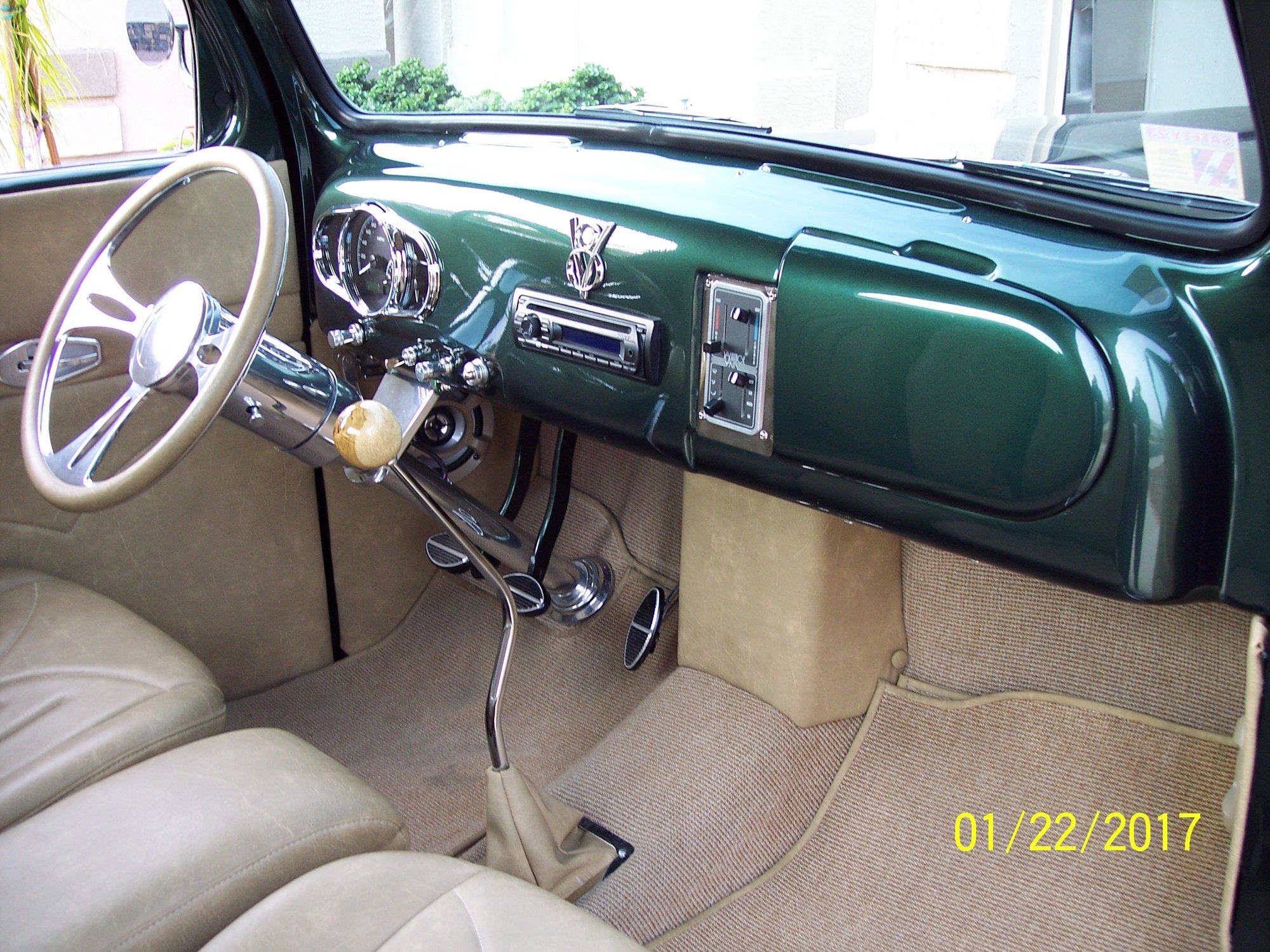

Old Dec 6, 2018 | 04:31 PM
electricmaniac's Avatar
electricmaniac
Joined: Sep 2017
Posts: 235
Likes: 25
From: Solvang CA
T-5 from S-10 is what works. You will have to modify to get shifter forward.
My T-5 is behind is behind a 239 Flathead with Wilcap (Pismo Beach CA) Transmission adapter.
I do not have a good shot through the door. Truck in shop and too hard to get to right now, but here are two pics I do have.
If you look close you can see round hole patch on rubber mat where old shifter used to be.
You can see Shifter is close to seat. You cannot use angled original shifter like it is.
Shifter needs to come straight up more or less like 48 Steel above.
Seems there was a guy in San Jose who did the shifter move mod - maybe my memory is not correct on this.
I would have liked to maintained original shifter location because I get a kid in the middle of the bench seat sometimes - then shifter is in the way (or is it the kid is in the way?)
T-5 is a nice Tranny - you will not regret putting it in!
