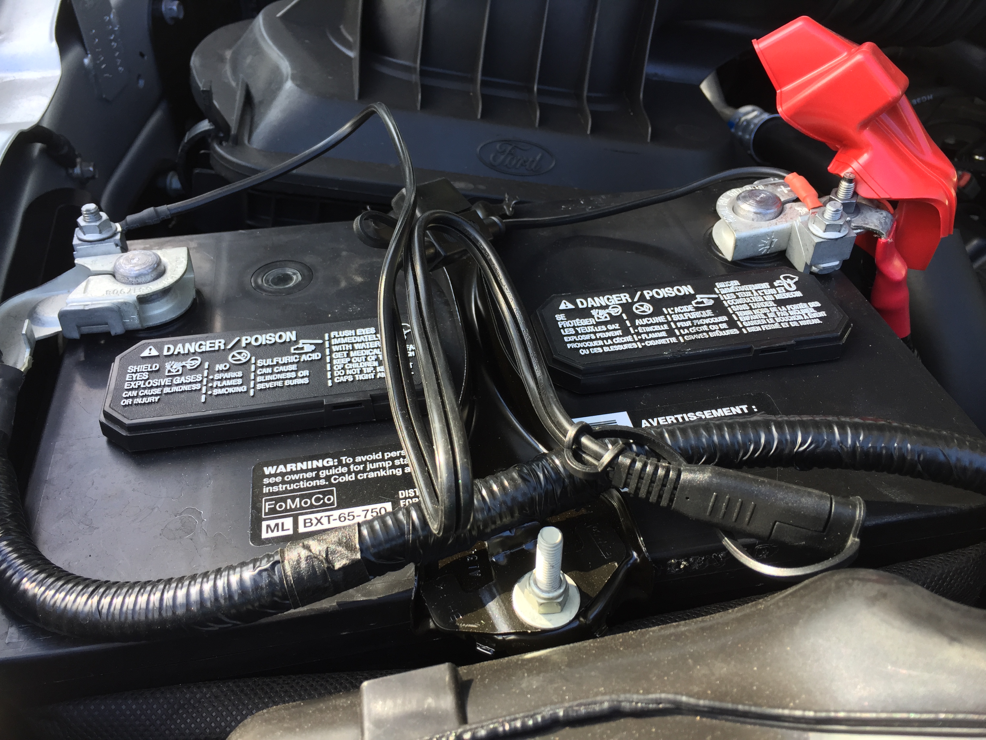

I did it this way:
Attachment 282627

Originally Posted by tibadoe
I did it this way:
I don't have any mounting bolts on my battery clamps.There is a small bolt the tightens from the side.My engine is a 6.7, wonder if it's different clamp for the diesel. Yours is the clean set up I'm looking for.
The picture above looks just like my 2017 F-250 6.7 diesel. Maybe the F-350s are different.

If you look closely at the right side battery cabe (in the photo), you will see a stud / bolt and nut installed from the factory in the positive battery cable. I drilled a hole in the left side (negative) cable and installed a similar stud /bolt and nut, then connected my charger leads to the studs.
