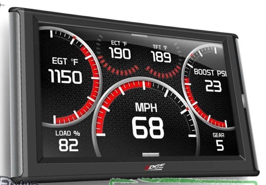

Today I got another weird symptom. The Edge Insight console lit up when I opened the driver door! The Edge is only supposed to come on when the ignition is on. My master tech friend said broken insulation in the door hinge area could cause that, but we looked at the loom there and it looks great. No visible breaks and the rubber is still flexible.
I wonder if my GEM is going south, and it's monkeying up both the power windows and the Edge. We used the Edge to check codes, but it has no codes logged. I learned here that the GEM can get water in it in early Super Duty trucks because it's attached to the back of the fuse box, so Ford moved it in 2002 to a safer spot. We put a new windshield in this truck, so no leaks now, but perhaps it was leaking earlier.

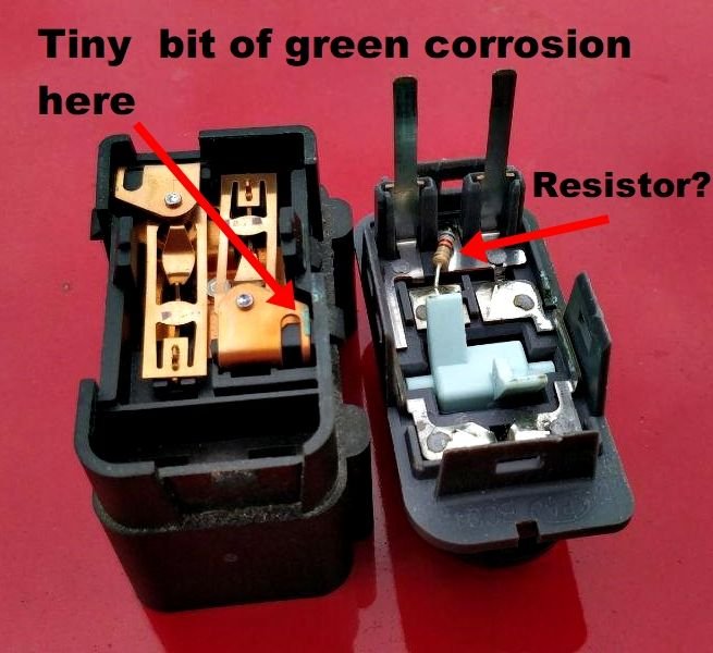

Hey guys, the door locks are acting up again today, inoperative, but occasionally will lock with the button. No problems for 6 months. To recap, we've
  1. Removed the GEM and looked for water damage, found none
  2. Cleaned up the multi-contacts and used tiny amounts of conductive copper grease
  3. Inspected the wiring loom in the driver door jamb and in the door, they look fine
  4. Inspected the driver door power door lock switch, it looks new, clicks fine
  5. Today I inspected the passenger door power lock, it looks OK, clicks fine (see pics below)
So your advice would be to open and inspect the back door switches now, rather than order a GEM?
I'm old so those small points in the switches remind me of ignition distributors. But they way the switches are built is pretty clever, such that they snap open or closed, reducing any micro-arc time. The passenger door switch is dusty but not inside. A little green on part of the copper suggesting water was in there at one point. But the green is not in an area that would affect its operation.
Do those resistors fail? If it did, would the switch ever work again? I bet I'll go out there tomorrow or the next day and the power door locks will be working again, for a day/week/month.

I think you're doing a little too much "inspecting" and not nearly enough testing. Get out a voltmeter, use the diagram from the thread you linked from, and actually test the window switches rather than looking at them and guessing they're okay because they look "clean". It can kind of cut it really early on perhaps, but at this point you've done a lot of looking and nothing "looks" all that bad. Time to start getting a little more in depth. Perhaps some continuity testing at the door jam wiring as well...
If you had access to a GEM with the same code as yours and you could test it for free I'd say absolutely give it a try. But finding one with the same code can be tough and they're not that cheap. I know it sounds easy to throw some parts at it, but if you're gonna start throwing parts, start with window switches for all 4 doors before you jump to a few hundred bucks on a GEM that also "looked" fine don't forget.
