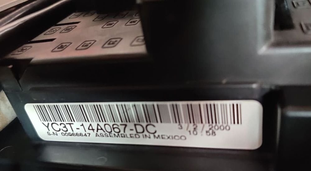

FORScan results lead me to suspect GEM is going sideways
As suggested by @burnthelight88 , @calvinhg and I just ran FORScan on that truck, with interesting results (we also updated Gearhead tunes how to do that). The first clue came before we'd even started, as we found the truck had locked itself in the carport. The alarm did not know, so it was not locked with the Viper keyfob. And during testing, we observed the truck lock itself again, then stick on actuating the door locks downward. Bad news. All actuators are new as of 2 years ago.
Anyway, FORScan shows three errors that don't make sense, C1446, B1352, B1575.
  • C1446 but brakes and brake lights work fine, no LED bulbs, that could drive a fault.
  • B1352 but there are no ignition key symptoms - that code may be because we defeated the open door dinger 3 years ago.
  • B1575 but no parking lamp symptoms, no LED bulbs.
I got a pic of the GEM with its part number and will order up a replacement. My normal suppliers for rebuilt electronics don't offer this GEM, so I'm turning to fleabay. Now would be a great time to warn me of any particular fleabay GEM vendor that done you wrong in a sad country song, as it were, probably also involving a lonely train station, a whiskey bar, divorce, lost true love, and/or a dear family member in prison but they didn't do it. That way I won't have to play a country record backwards to get my money back. If anyone remembers records. Or jokes. Or country music.

I don’t believe you’ll find a “vendor” for GEMs that you give the code to. Not that I ever had to replace my own, but my understanding was always that you need the same code and it’s literally a matter of searching eBay, Amazon, and all your local junk yards.
I guess what I’m getting at, again as I understand it but with no personal experience, is that these cant be programmed to match yours, it’s literally a matter of finding the same one in another truck, and then hoping it is somehow in better condition than yours. Always sounded like a needle in a haystack to me.
