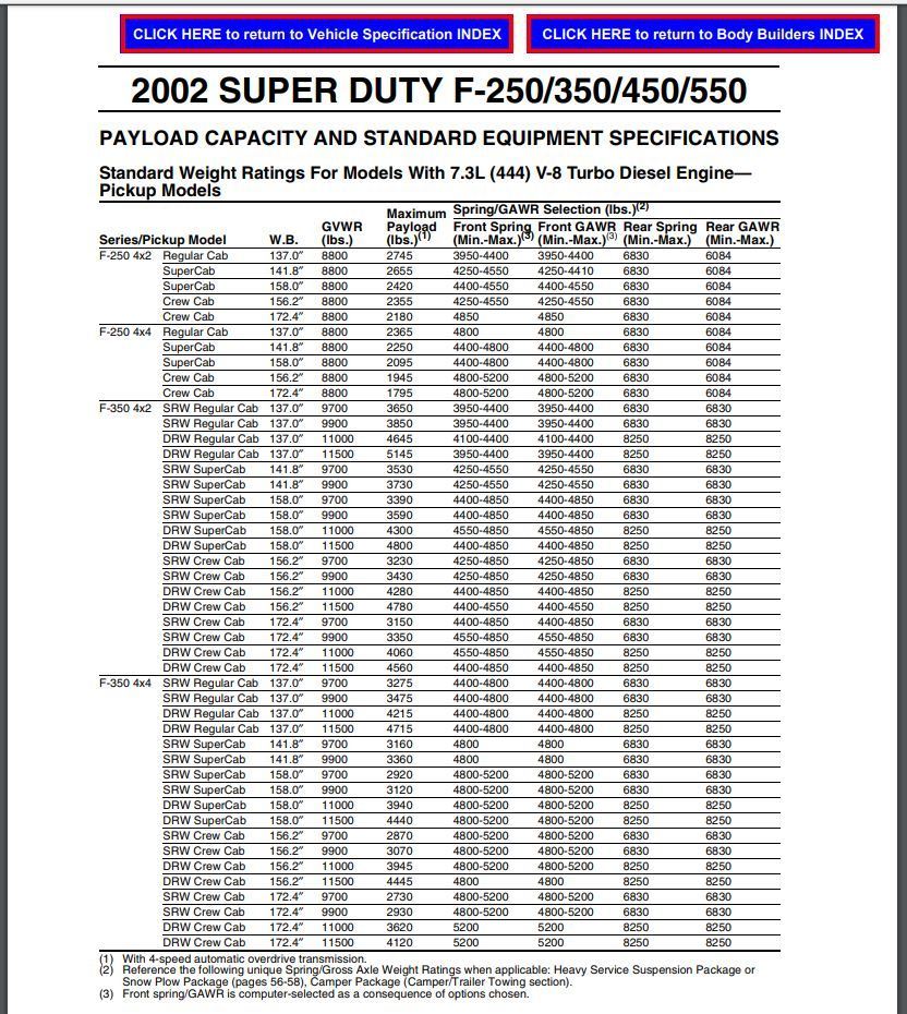

Recent preparation for towing a TT has got me checking numbers. According to Ford, my GVWR is 9,900 and my payload is 2,930 (2002 F-350 4X4 crew cab SRW Long wheel base AT 7.3) . This would indicate a curb weight of 6,970 and I have read differing opinions if that includes fluids and fuel. If it includes fuel then I am even worse off than I thought. A recent CAT scale weigh shows me at 8,860 with a full tank, people, luggage tools, camper shell and everything else I could think of (see pic). Weights are actual on most items and estimates on those things not easily weighed however I tried to estimate high. My tires are about 14 lbs heavier each than the stock ones and I guessed at 10 lbs each for the Lariat wheels over the stock wheels for a total of 96 lbs. I went over everything carefully and even considering minor inaccuracies I cannot account for about 400 lbs. Any ideas on this, could it be that the actual delivered curb weight differed that much?

Oh, wait, what? You actually want Air Conditioning in your truck? That adds 44 lbs to the front axle, unloads the rear axle by 3 lbs... so subtract 41 lbs from your 2,930 lb payload capacity.
You've got to be kidding. You want running boards so you can step up into your cab? Add 47 lbs to your front axle, add 29 lbs to your rear axle, so subtract 75 lbs from your 2,930 lb payload capacity.
Oh my gawwd. XLT trim? Seriously? Such decadence. Add 89 lbs to your front axle, add 4 lbs to your rear axle, so subtract 93 lbs from your so called 2,930 lb payload capacity.
No. Way. LARIAT trim? You've got an oil well in your back yard? Add 117 lbs to your front axle, add 19 lbs to your rear axle, so subtract 136 lbs from that 2,930 lb payload capacity that you were roped in with.
Shut up. Off Road Equipment package? In a 4x4? That's a surprise. Add 41 lbs to your front axle, add 27 lbs to your rear axle, so subtract 68 lbs from your 2,930 lb payload capacity.
I could go on, but you get the idea. The payload capacity is based on an absolutely stripped, minimum configuration, bare bones base model with zero options other than required equipment mandated by FMVSS laws, with one driver weighing 150 lbs.
Adjustable pedals? Subtract 5 lbs from the payload capacity.
Even the factory receiver hitch, which is considered by Ford to be "Recommended" equipment for towing, but not "Required" equipment for purposes of publishing payload capacity, means that you need to deduct an additional 49 lbs from your 2,930.
It isn't you or your stuff.
It is the misleading marketing of the industry.
It all adds up.
