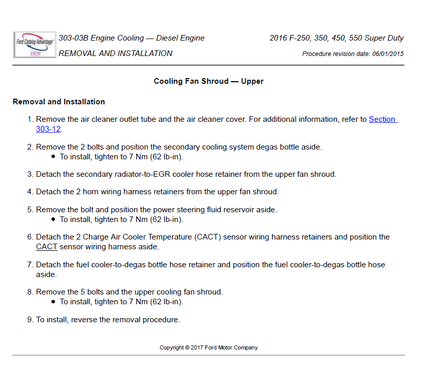

I'm assuming you have to remove the radiators to remove the fan blade?

I think you can remove the shroud and get to the fan that way.

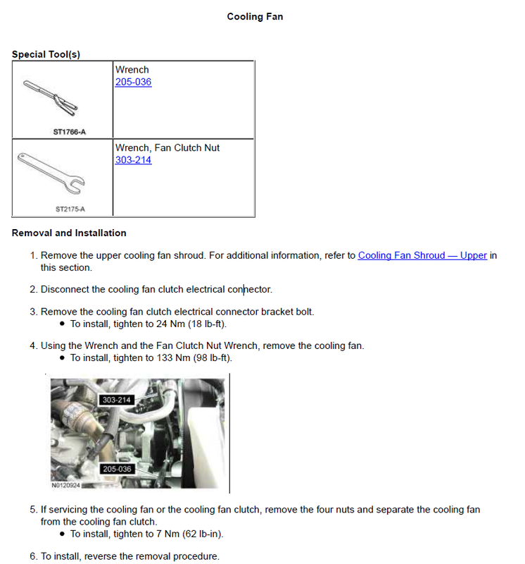

Nope, upper fan shroud is removable.
https://parts.autonationfordwhitebea...OC1kaWVzZWw%3D
Doesn't sound very difficult and the fan is less than $100. I'm sure your deductible will be more than that. If the fan clutch was damaged that might be another story.
https://parts.autonationfordwhitebea...wtdjgtZGllc2Vs
