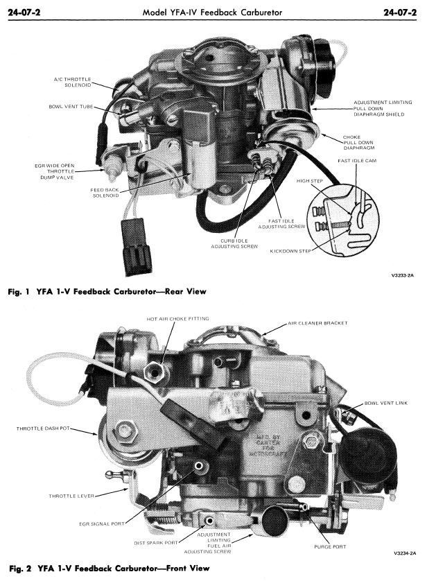

Well, it doesn't look like a feedback carb to me - because I don't see a feedback solenoid (see picture below). Granted, my picture below is from the 1981 manual. I do see many additional control features on yours that mine does not have, but it looks like almost all are vacuum controlled (not electrical, as the feedback solenoid would be). The only electrical connection that I see (besides the electric choke assist) is a single-wire control on the backside of your carb. Behind / in-line with what looks like a throttle dashpot. I don't know what it is / does. Do you have cruise control on your truck? Lots of vacuum hoses that I'm not familiar with in your pics
