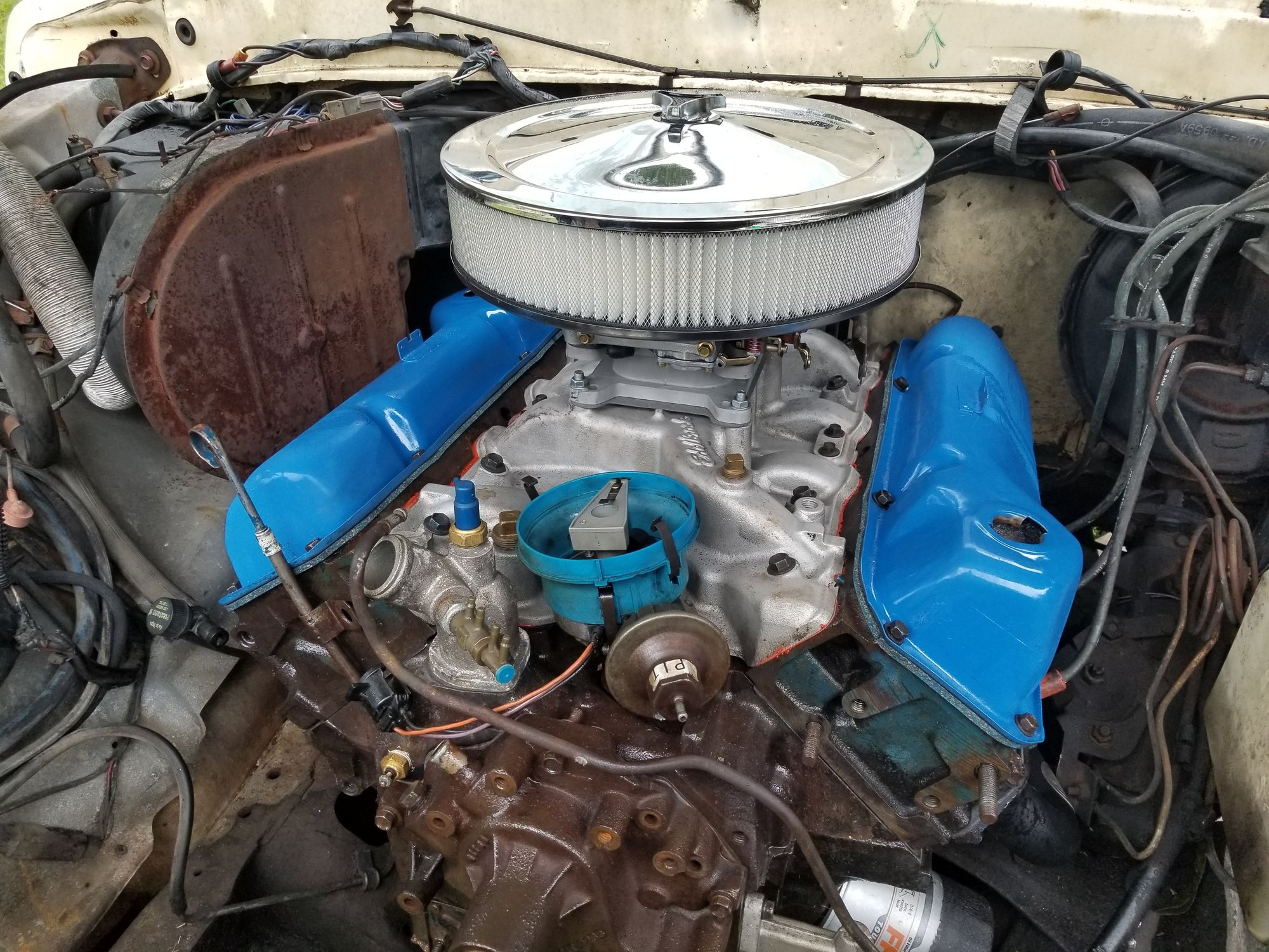

Did the break in last week, runs great. A few tips I learned, I saw where someone asked about rotators. The Edelbrock cam manual said to use their springs but the number they gave for the rotator springs were discontinued, I just used the standard springs and on initial startup bent all but 5 pushrods. Since I had a second motor I used the non rotator spring caps from it.
. I made a tool from 1 inch box channel, use a pry bar to compress the springs and a string tied around the valve stem to keep it from dropping. This was my first engine rebuild on anything over a twin cylinder. I tried to purchase most useful tools, it did seem like every time I purchased something for the engine, I would then need another part and so on. I tried my best to research everything in advance and seemed like I still wasnt prepared. I sure hope the second motor goes smoother.
. I am getting about 19 in of vacuum at idle and well over 22 at a fast idle. I had to take the electric choke module off the carb and smooth up the fast idle screw tip because it would stick and the idle wouldn't drop, that took awhile to figure out why even with all the screws turned out the idle was still really high.
I have
TMI pistons
cleaned up heads
new valves
Edelbrock springs
Edelbrock cam
Edelbrock timing set
Edelbrock intake
Holley 600cfm
2 inch riser
Still want to add an oil cooler
