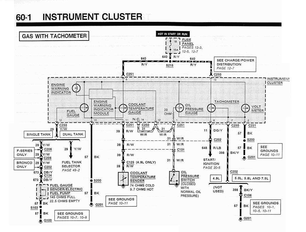

Yes you have to ground pin #10 for a V8 and leave it ungrounded for a I6 for it to work right (accurate).
This is grounded (jumped) at C250 pin #7 to pin #10.
You did not state the year so I will post for a 1992 F-series.

It works the same way as the 1992 above but it does use different pin numbers.
The diagrams below are for a 1990 but a 1991 should be the same.
