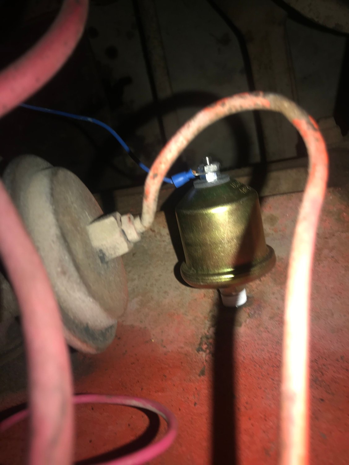

I got the sender from Napa auto parts, while I’m driving it’s just below 80, I did see it go down to 30 after udling for several minutes but as soon as I give it gas it’s right back up to 80.

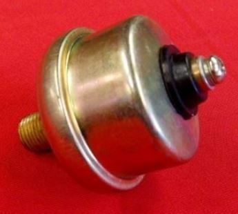

As far as I know, NAPA doesn't sell the type of oil pressure senders used in our trucks. I suspect they either sold you a pressure switch, or a sender for some more modern Ford. Does your sender look like this?

Yes that’s what they called it a switch, and yes it looks like that.

You have the wrong sending unit. You need one like this, rated for 80 psig.
Oil Pressure Sending Unit 80 Lb | Dennis Carpenter Ford Restoration Parts
