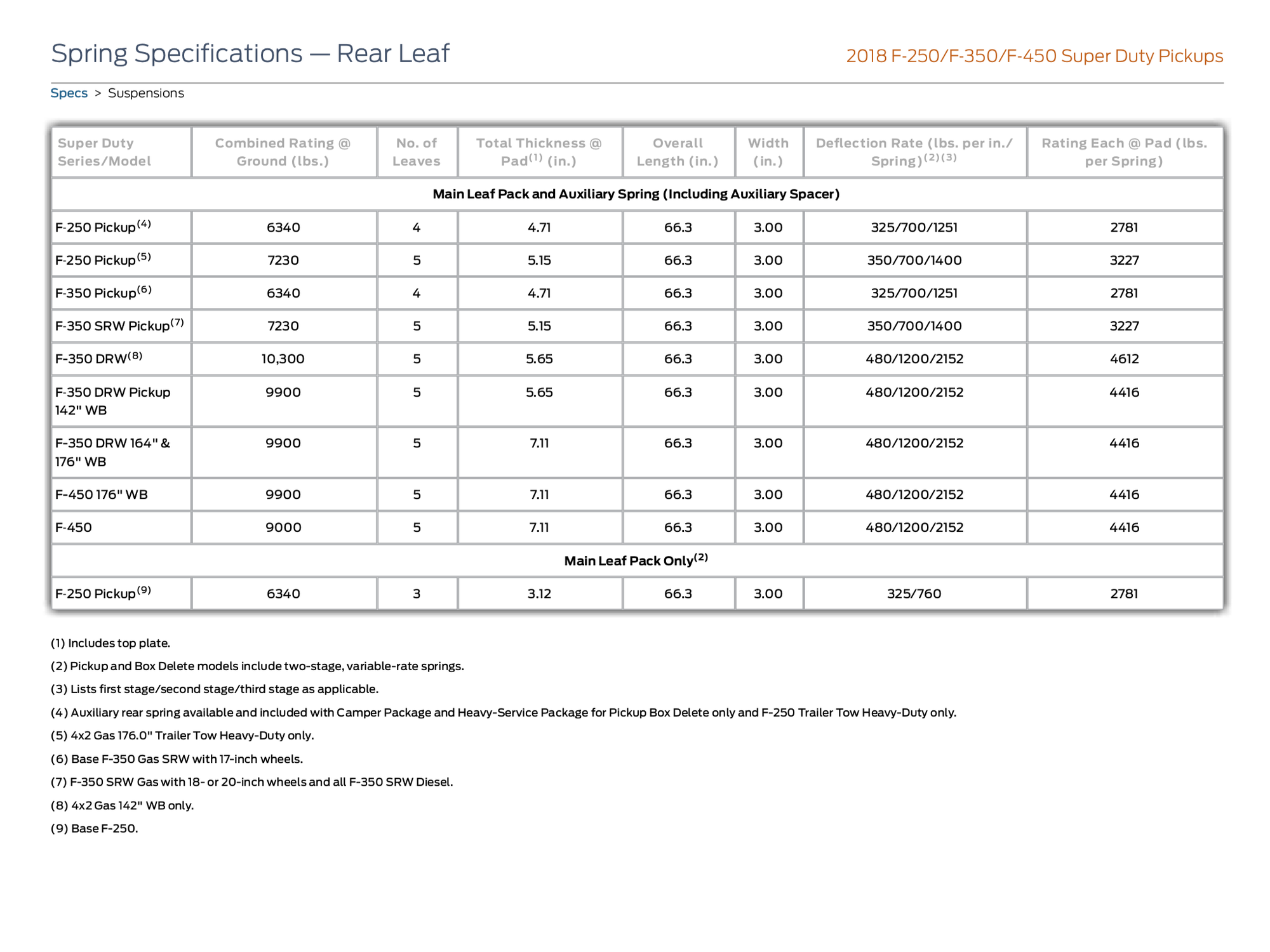

Excuse my ignorance, but I'm not finding an answer to my question(s) regarding leaf packs. I have a 18 f250 with the 6.2 gasser engine, no camper package etc. I count three leafs per side in the rear....I ordered a BDS 4inch radius arm lift and they asked if its a two leaf or three leaf main pack. I mentioned that i count three leafs but the order shows two leaf pack under the options on my invoice. Is this correct? Or do i have a three leaf pack? Thanks in advance and STG3 Motorsports has this kit on sale through today (11/26/18) for roughly 1500-1600 with the fox shocks as an upgrade with free shipping on the gas engine for those who are interested.

Ford’s specification document says your truck is fitted with three-leaf rear spring packs.

Thanks SDcrewzer. I got off the phone with BDS and they basically said the same thing. Seems like the STG3 Motorsports guy was incorrect.

Good news, and thanks for feedback. I added a spec chart to my original post above.
