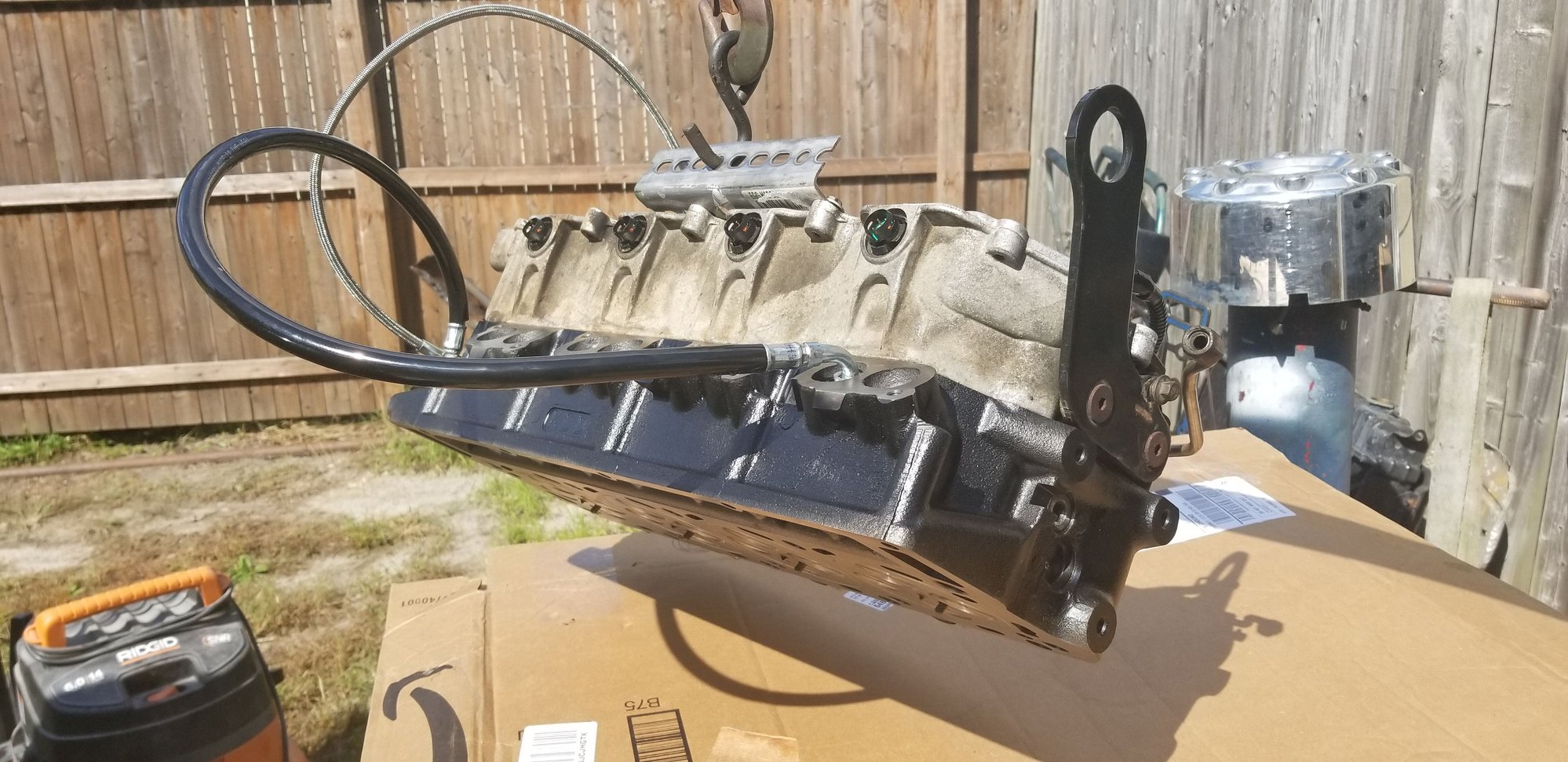

Also take note of my "custom" head bracket for lifting. It is simple multi-hole angle for shelving available at Napa for a few bux. It was the perfect angle for setting the heads. It is bolted to the valve cover holes on the rocker box with 2 bolts. I used my engine hoist to lift & set the heads.

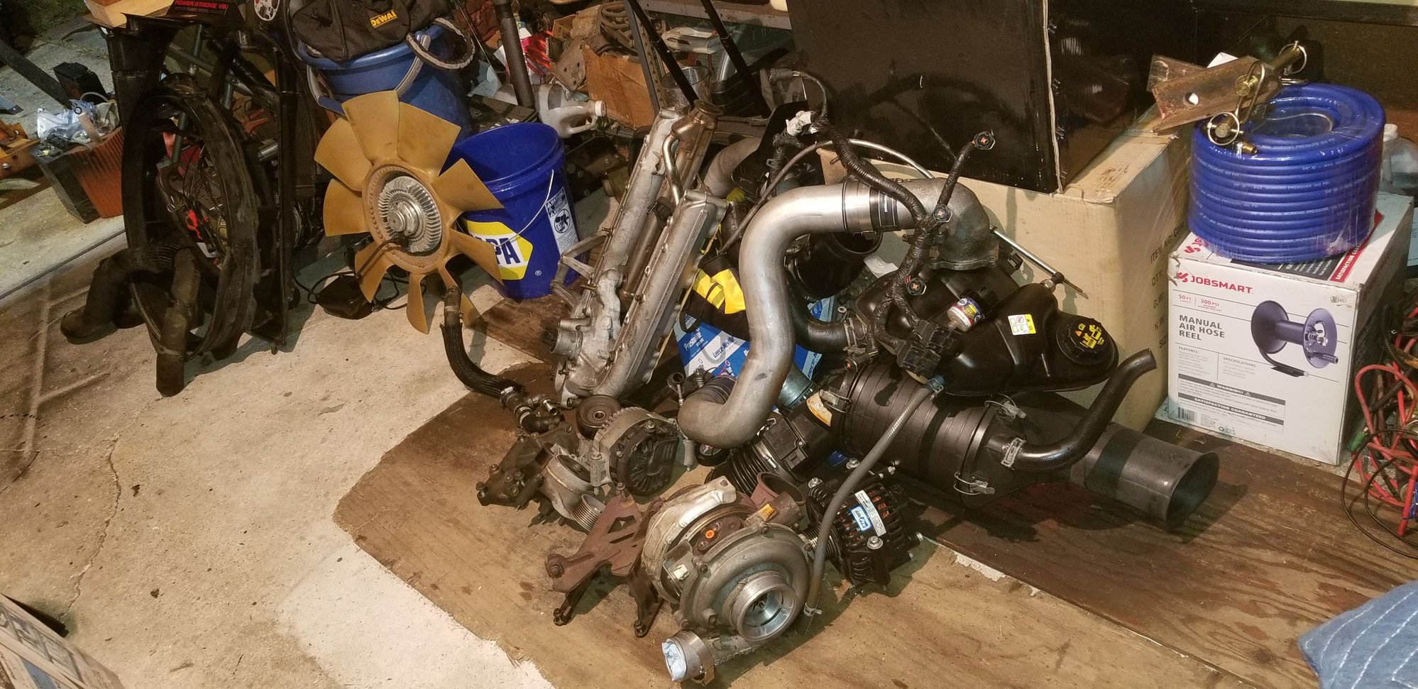

make room, you'll have a pile of parts.

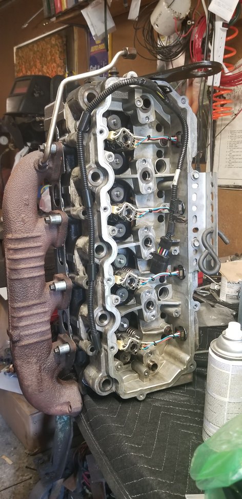

This is with the engine jacked up to remove the driver side head. You can get all the bolts out with the engine tilted.
Coolant line bypass kit and fuel crossover kit installed.
New Kill Devil Heads.
Lifting Bracket, ready to go on.
