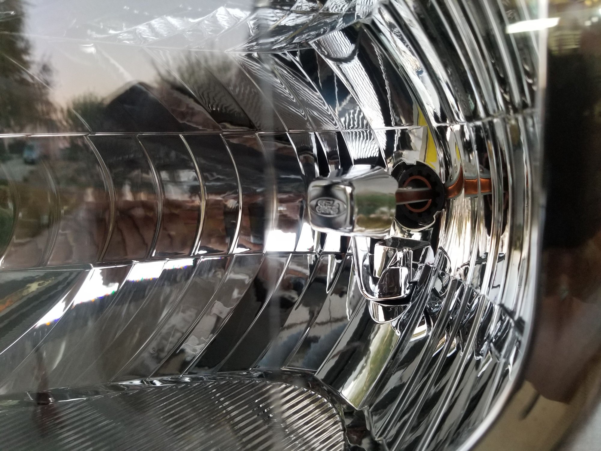

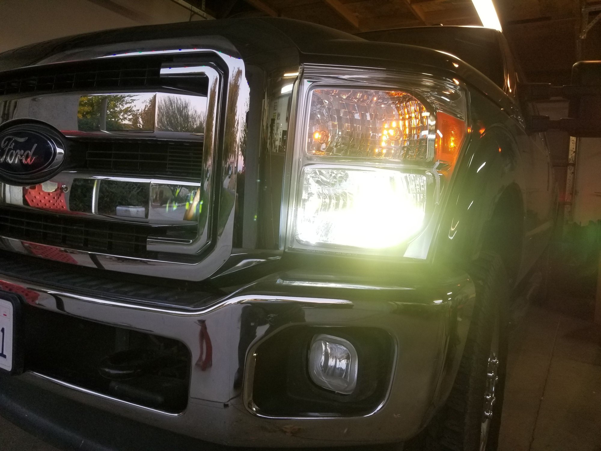

I used my factory housings, ordered a direct match up to stock bulb number from a company called opt-7, on amazon.
These lights utilize 2 large led elements instead of a bunch of little ones. You have to make sure they are oriented correctly on install, i.e. low beam on bottom. The only adjustment is you will have to adjust the factory housing up a little using the adjustment screws.
These lights take a little getting used to since you wont get the 2 pronounced beams that you are used to. More like a flood, but after a few night drives, you'll be glad you did it.

well, then it just comes down to a matter of opinion.
I can assure you, my led chips are one on top, and low beam on the bottom. That is the only way they go into the housing. When the low beams are on, the bottom half of the housing is lit only,,,,and I dont get anybody flashing their brights at me because they are blinding them. If the chips were side to side, I would not have bought them.
if you look at the pic I posted of the unlit headlamp, you can clearly see the wide part of the element where the chips are mounted is is top and bottom.

I think you misunderstood what you quoted above I didn’t mean that there is no led bulb that fit into a super duty headlight housing, I meant I’ve never seen a aftermarket head light housing that had a built in led for the headlight like how the new super duty is configured with the oem led headlights which was what I thought the op was asking about. I can see which way the leds are facing in your lights and that’s why you posted the above statement, and I hate to tell you this but they are facing the wrong way the housing is not supposed to reflect light that way it is supposed to be done mainly off of the left and right side of the housing just look at the reflector that’s why you don’t have the same light patten as you do stock with the bulb. If that’s the only way they will fit that doesn’t mean it’s right it means you need to get leds that fit the right way. When the leds are positioned facing 3 and 9 o’clocck you would have much better results and you would also have better results if with an led that had the chips in the positioned like the filaments for the halogen bulbs would be like the ones I linked. If you don’t want to listen to me that’s fine I’m not trying to or going to argue with you I’m just giving you the facts and trying to help. I’ve done far more research than most on the subject. I was one of the first on here to try led headlights and have had several different sets to test out and helped other members on here with them including one guy with the same 11-16 truck with the same headlight housing as as yours to get the lights facing the right way and improve not just his low beam but actually give him a functional high beam. If you get different leds like the ones I linked you will have far better results than what you have now.
