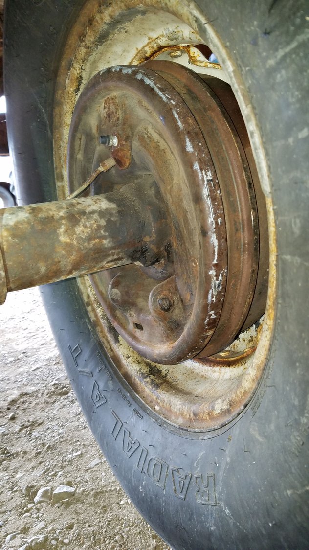

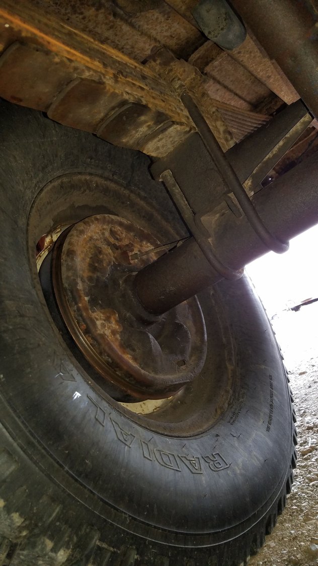

Good morning, everyone! My truck's rear brakes have issues. The drum does not cover all the way to the backing plate on the driver's side. I think it has the wrong rear backing plates as well. Can anyone tell from the pictures what's wrong?
Passenger side
Driver's side
Driver's side

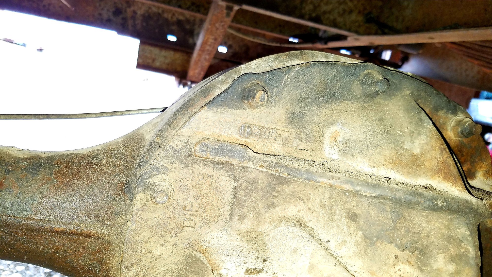

Date code, Am I correct 9/1/1964?
Old Nov 23, 2018 | 11:54 AM
NumberDummy's Avatar
NumberDummy
Ford Parts Specialist
Posts: 88,826
Likes: 787
From: Simi Valley, CA
4J1 = Assembled September (J) 1, 1964. Would have originally been installed in a 1965.
Old Nov 23, 2018 | 06:36 PM
Alongfortheride's Avatar
Alongfortheride
Joined: Nov 2018
Posts: 42
Wrong drum would be my guess
Old Nov 23, 2018 | 07:16 PM
NumberDummy
Posts: 88,826
Likes: 787
C4TZ-1126-A (replaced 8M-1126-A) .. Rear Brake Drum-Use with 11" x 1 3/4" rear brakes / Obsolete
1949/51 Mercury; 1957/67 F100.
Pic: See 5th entry for the specs of C4TZ-1126-A

Old Nov 24, 2018 | 11:04 PM
cosmofennema's Avatar
cosmofennema
Joined: Oct 2018
Posts: 368
There is s small chance the axle has started to come off the bearing. I have had this happen to Ford 9" axles, though mine came ALL the way out.
