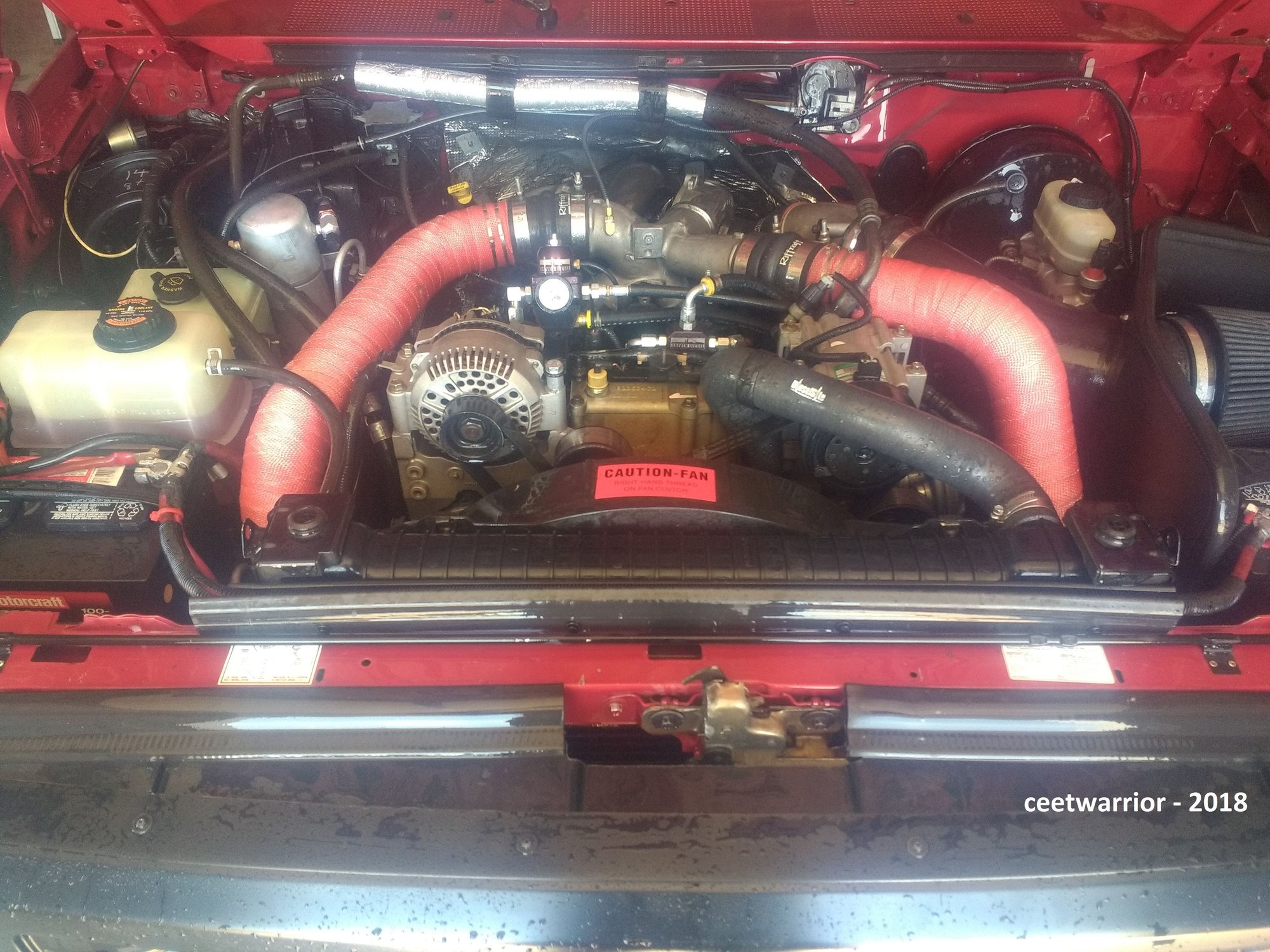

Hey guys, happy thanksgiving! I've done all I can do in preparation for injectors and after 3.5 years of owning my CCSB I'm tired of it be so slow. I've never installed or removed injectors before. Any tips or recommendations is appreciated.
97 7.3L 185k miles
4:10 gears / 35" tires
"Built" E4OD/converter/cooler etc
Super Duty intercooler
Riffraff wheel / stock turbo, good condition
AFE air intake
Driven Diesel E fuel system
High flow fuel banjo bolts
3" DP / 4" exhaust/muffler
Terminator T500 HPOP
Gauges / makes 23PSI at redline currently at 6000ft elevation
I tow fairly heavy but nothing extreme. I do plan on upgrading the turbo in the future but I don't think I'll go T4 or anything. So maybe a 38R at most, I dunno?
Thank you in advance!

I agree, you can't go wrong with stage 1's. You see what I pull with them, 18K, You get the 1's and you'll smile all the way to where ever your going! lol Very nice looking engine compartment!

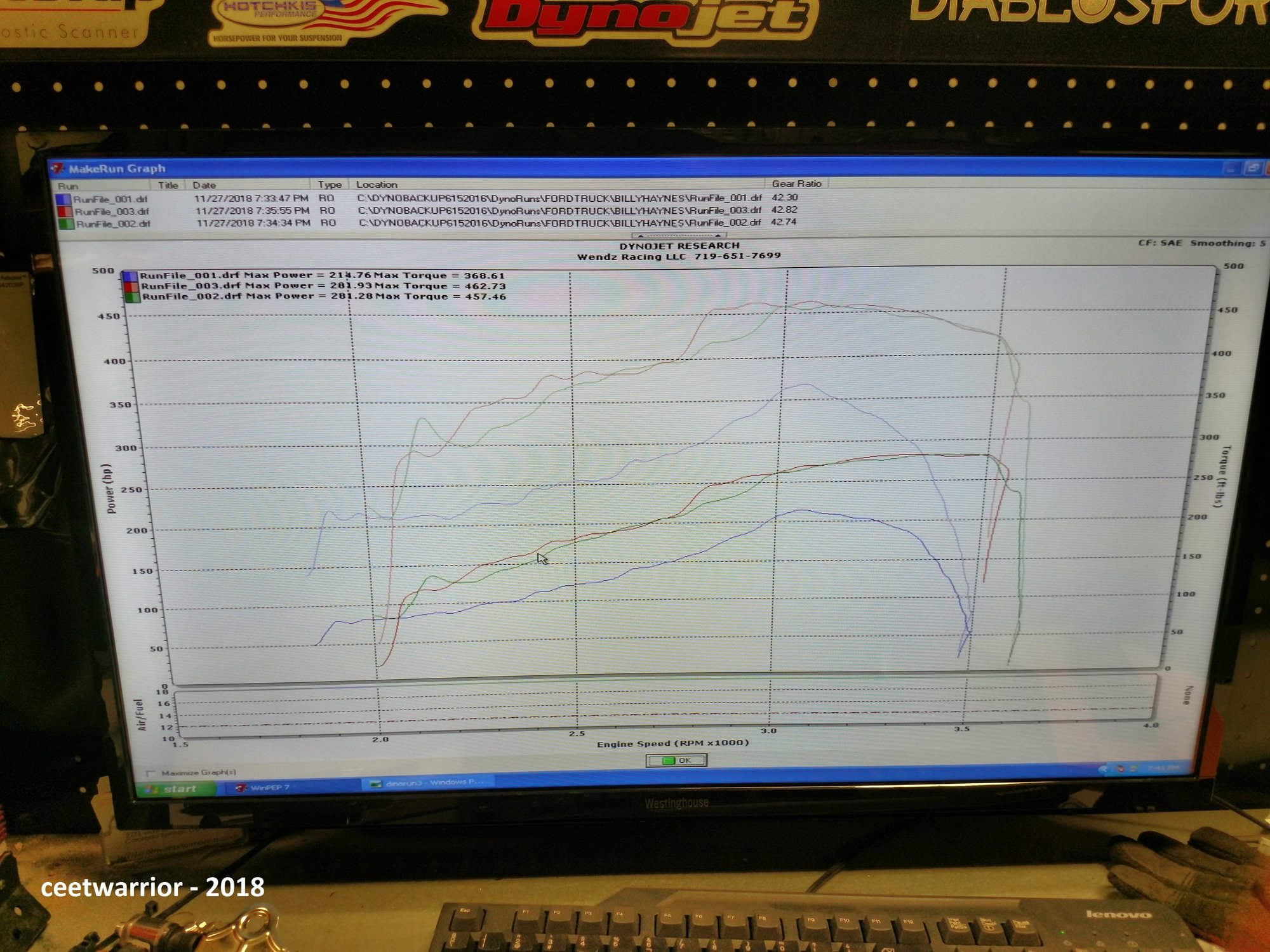

Hey guys, I did a baseline dyno run of my truck. With the mods listed above it made 215/368 with chip off. With the TS-6 with unknown tunes set on high it made 282/462 at the the wheels on 35"x12.5's.

That's a very optimistic Dyno.

Well I dunno what dyno's you're used to but this is a Dynojet which is pretty much the industry standard in dyno's. These are SAE corrected numbers of course which are also the industry standard of comparison. I don't give a crap about the whole "uncorrected is real blah blah blah" talk. Everyone claims that some dyno's are "heartbreakers" but I've been on many of dyno's with many vehicles and they all read about about the same with 20hp or so as long as the correction factor is same then it's apples to apples.
