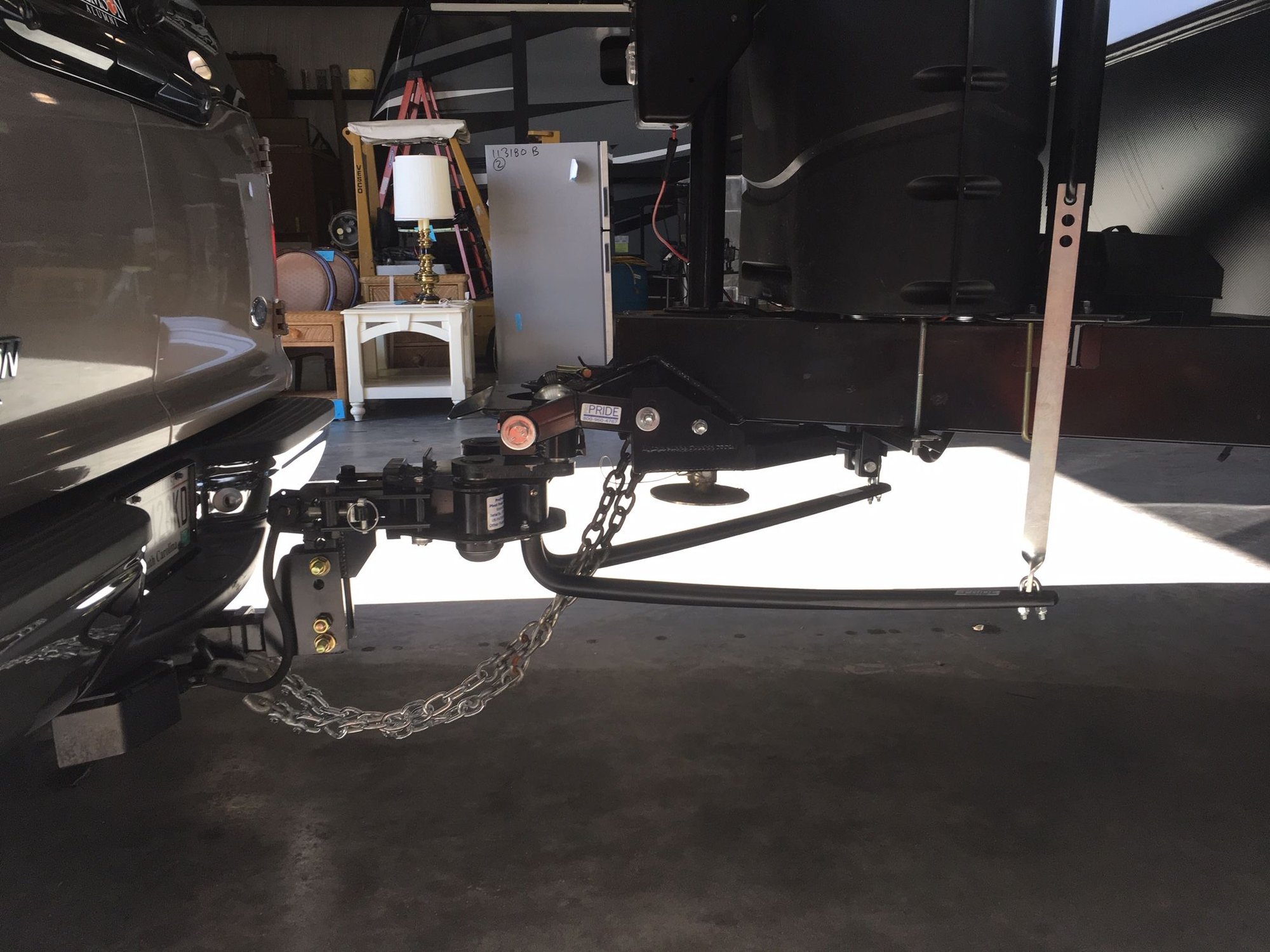

So I posted some pics in the camper pulling thread, but wanted to post a separate one to get some advice on the setup for my new TT and ProPride hitch. You may, or may not, be able to tell in the pics, but the trailer is a little nose up with the hitch bar at the highest height and all 4 washers on the adjustment pin. Here are my numbers for a trip over the scales during our tow home (sorry I forgot to get a weight with the TT hitched, but no force on the W/D bars).
Hitched with 5.5" on W/D jacks:
truck front: 3500
truck rear: 4820
TT Axles: 6100
TT unhitched:
Truck front: 3580
Truck rear: 3900
TT: 6920
I would say that I am getting good W/D to the front axle, but there was a bit of "jerkiness" (feeling like the TT was pushing on the bumper of the truck going down the highway) which Sean at ProPride said could be due to too little tongue weight. I have since lowered the hitch bar by one hole and removed a washer from the adjustment pin. I have not had a chance to revisit the scales, plus I need to load the truck and trailer for a trip to get "real" rather than empty numbers. Regardless, I was wondering if some more experienced ProPride users could give input if you feel my adjustment to the hitch bar and washer will get me to a more level ride without jeopardizing my W/D. I am assuming that I may just need to crank on the W/D jacks a little more with the lower hitch bar. Thanks in advance for the feedback.

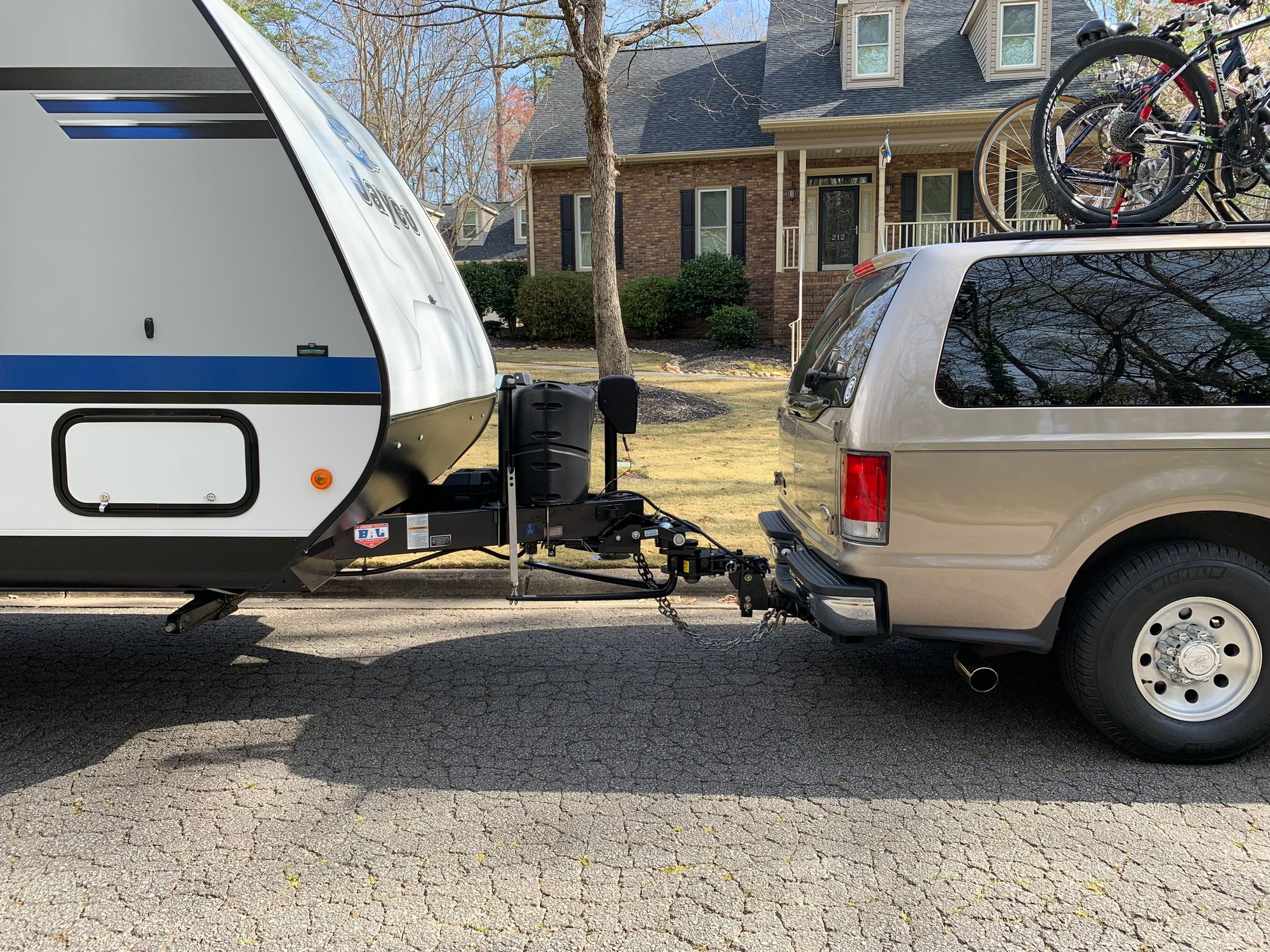

So I have done a couple more pulls this season and I think I need to dial in the ProPride a little more. I am experiencing a little "jerky" drive while on the interstate and based on what I am reading I think its due to the fact that my TT nose might be slightly above level. I started with the PP stinger up as far as it would go based on the measurements we took at the dealer from floor to frame when we first installed the hitch. I am thinking that this trailer might have an upward angle tot he frame and that fooled us. As mentioned above I did lower the stinger setup by one bolt hole, but I am thinking I should still go one more. I also had reduced the number of washers from 4 to 3. My question is if I lower the stinger by another bolt hole and put the 4th washer back in, do I risk adding more tongue weight back to the TV? I think I am really close to the 1000 max tongue weight. This leads to another question. How do you all measure the tongue weight with a PP? Do you install the stinger and use a tongue scale under the stinger where is roughly exits the truck, or do you weigh under the hitchbox, or under the hitchbox where the trailer ball is?
Here is a picture of the latest setup. Keep in mind the trailer is on a slight downhill slope and the truck is the other side of that slope, so this is what leads me to believe I should go down one more hole with the stinger setup.

Don't go to low, the stinger can ground out (ask me how I know). Are the truck and trailer level when you look at it from a distance?

Also, I have found that I need to let the back of my Ex drop 1" or so or else the trailer feels squirrely, almost like the trailer is a slight bit tail heavy when level.
I still have the stinger assembled with the truck side having the bracing facing upward, so I don't think that one more bolt hole down will cause an issue, but I understand your warning. I am already pretty low with the 2WD and stock suspension (only mod is Roadmaster RAS). I do think that my trailer is still a little nose up on level ground that is why I am debating the adjustment. Main issue is that I don't have nice level ground to check without hitching the whole rig and towing to an open parking lot or somewhere other than the house and then it is not as easy to have the necessary tools to make adjustments :-(.
