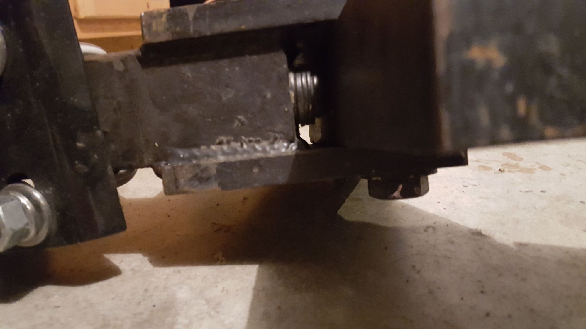

And how many washers do you have on the pivot pin?
You are referring to the button or center bolt?? Either way I will have to look.

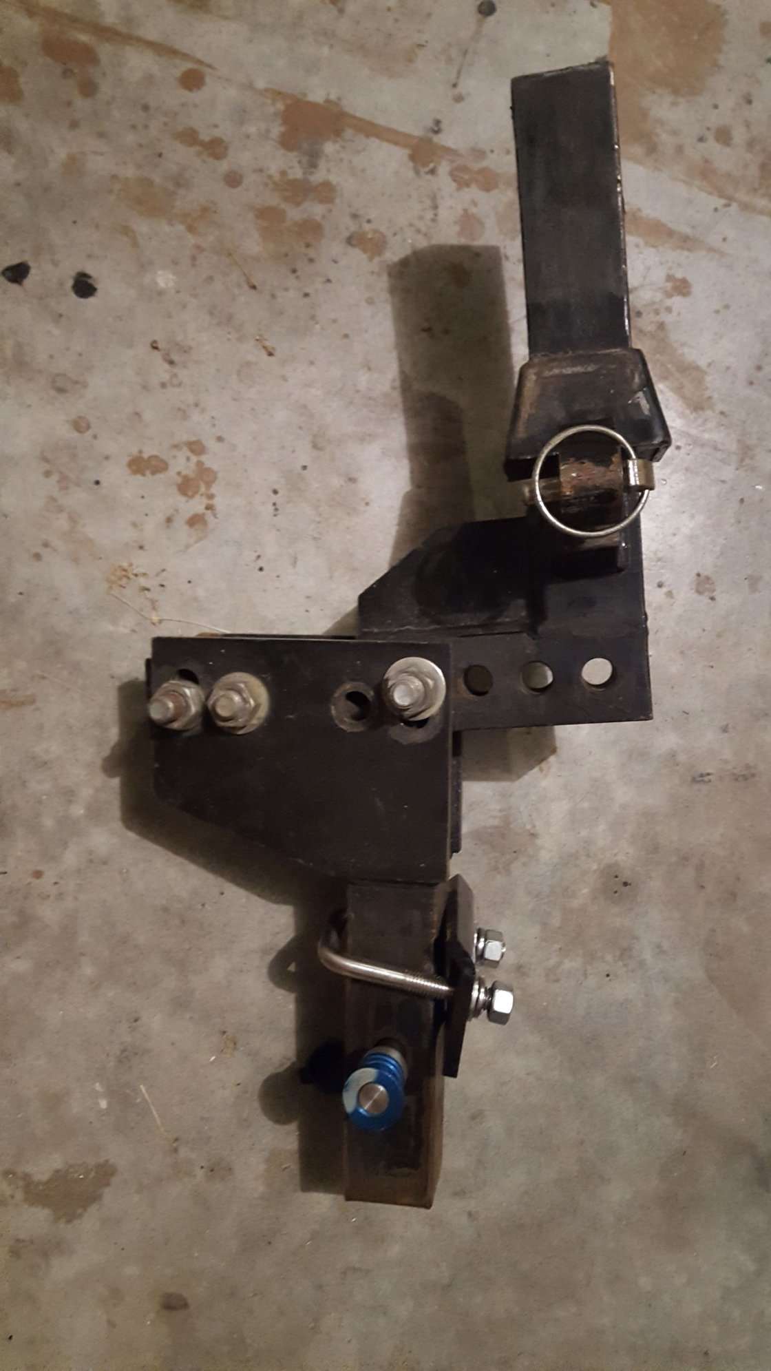

Here are pics of my stinger. Note the downward slope, makes it easier to add weight distribution and to hook and unhook.

THat looks like 4 washers if I am seeing it right.

My hitch has 3 washers installed. I am in the middle hole where it attaches to the jack. Your numbers look OK to me. You could push a little more back on the front axle, but it should be OK. I haven't found it to be critical regarding how it feels to transfer it all back to the front.
