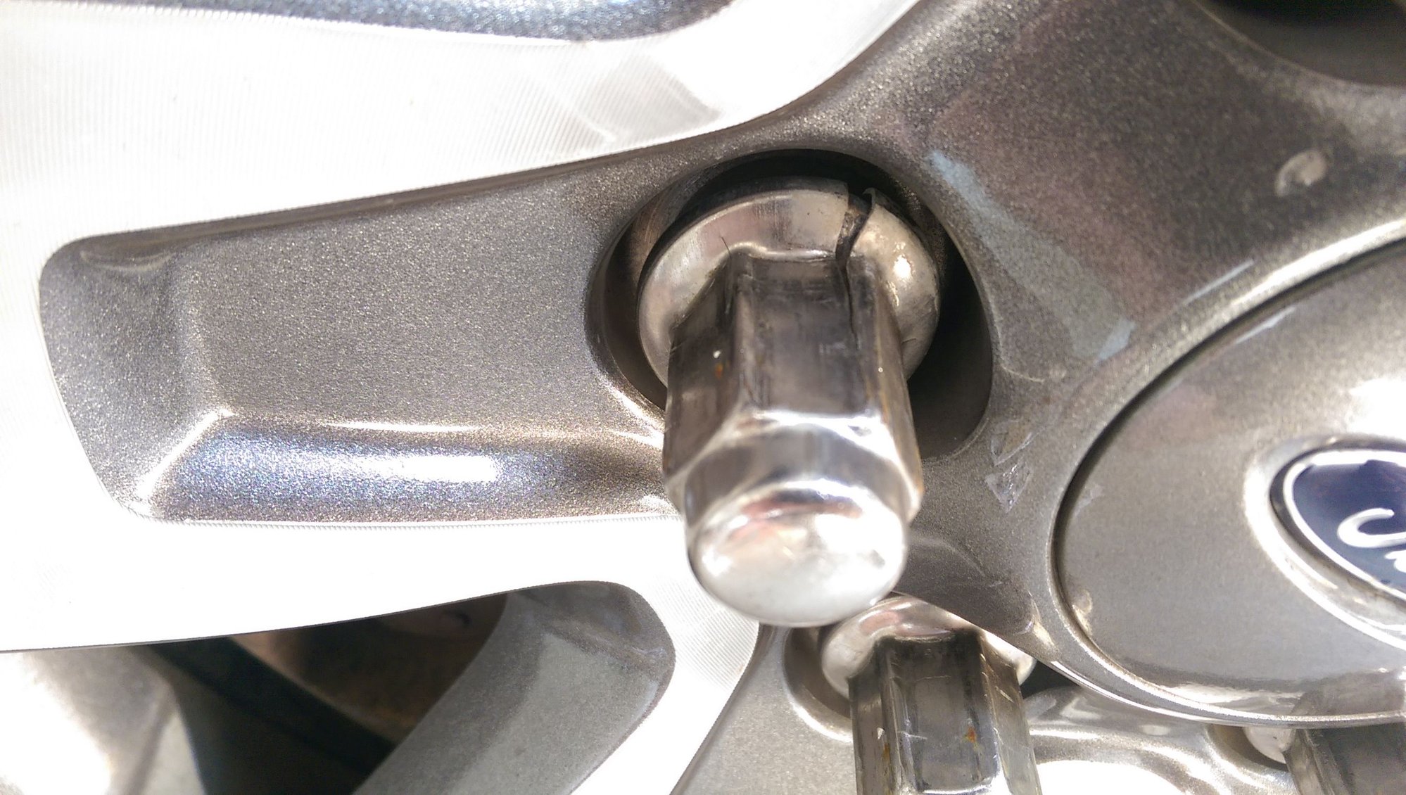

Not sure if they changed the design of the lug nuts on the '15+ but on mt '13 the chrome OEM "caps" started to split out and misshape.
did use impact to remove/install but limited the torque and finished with torque wrench. Pretty weak that a truck can't handle an impact.
Ended up replacing with a solid set from Gorilla. My Write-up HERE
