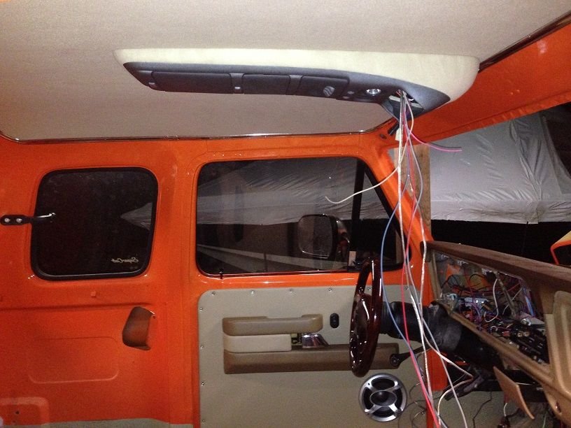

I went a more conventional way to get a semi modern look. The base of the panel is 1/4" plywood and the armrest is multiple layers of 1" plywood to achieve the contours I needed and the color insets. It was all then covered in 1/8" high density foam with vinyl over that. The base panel did not require any stitching but to cover the arm rest there was some seams that had to be sewn to fit the contours.
The screws are countersunk washer screws. If I were to do it again i would put flat washers under the vinyl to reduce the indentation the screws make. I wanted some indentation but I got more than I wanted.
The door speaker is close to the stock location. The last pic you can see the slight overlap of the OEM speaker hole. The overlap is about the amount that had to be removed from the door.
To have a reasonable amount of arm rest width the door lever had to be extended inward (towards the center of the truck) about 3/4". The allowed me to have a full 3" of arm rest and have the handle be flush with the armrest. As a side benefit it also added more leverage to the handle for opening the door (not that it was needed but it sure makes the door unlatch real easy and smooth now.
Cost wise these were fairly cheep, the wood cost way less than the vinyl did. Having flat spaces also made intergrating the power door lock and power windows switches pretty easy too.
