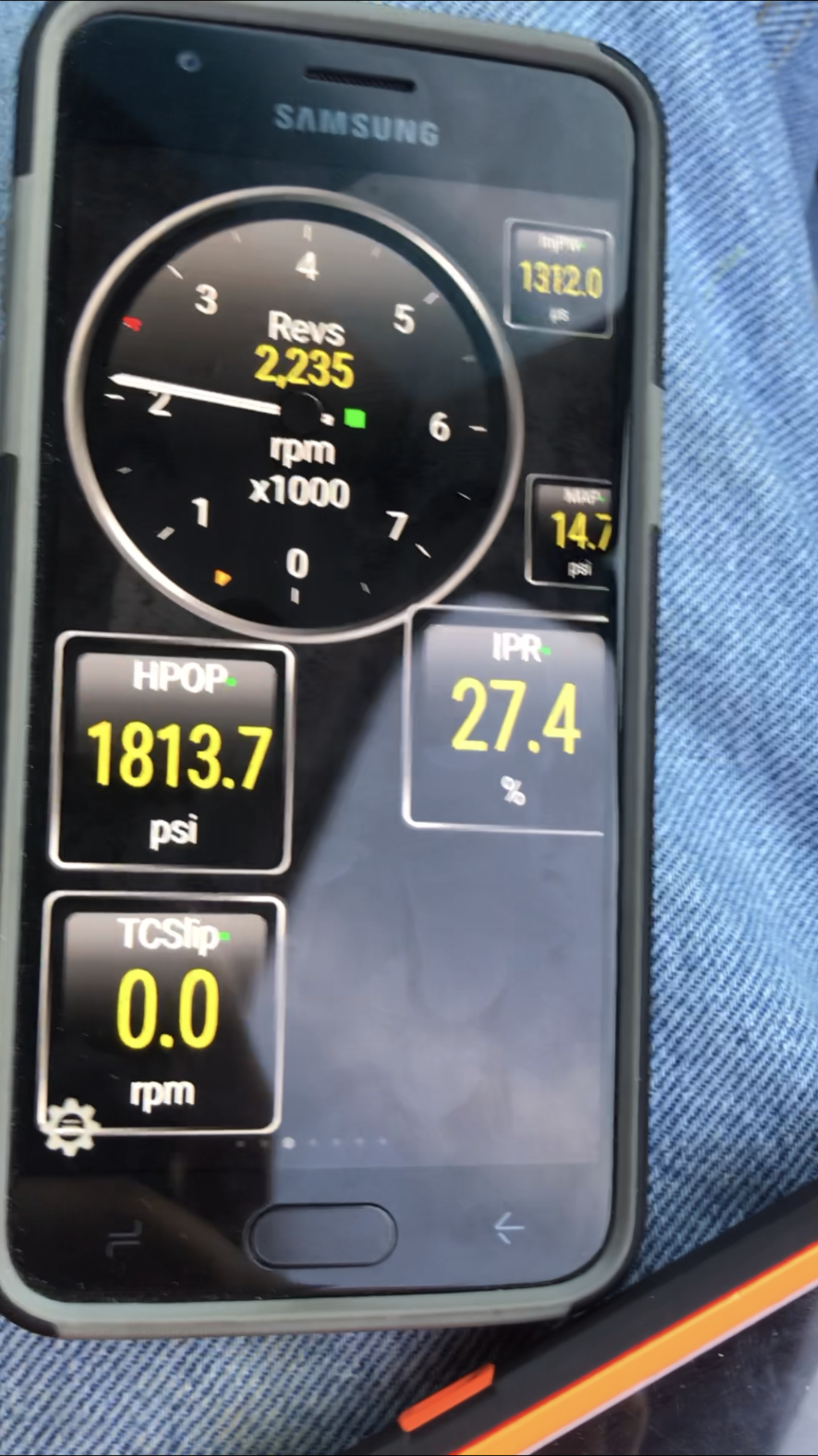

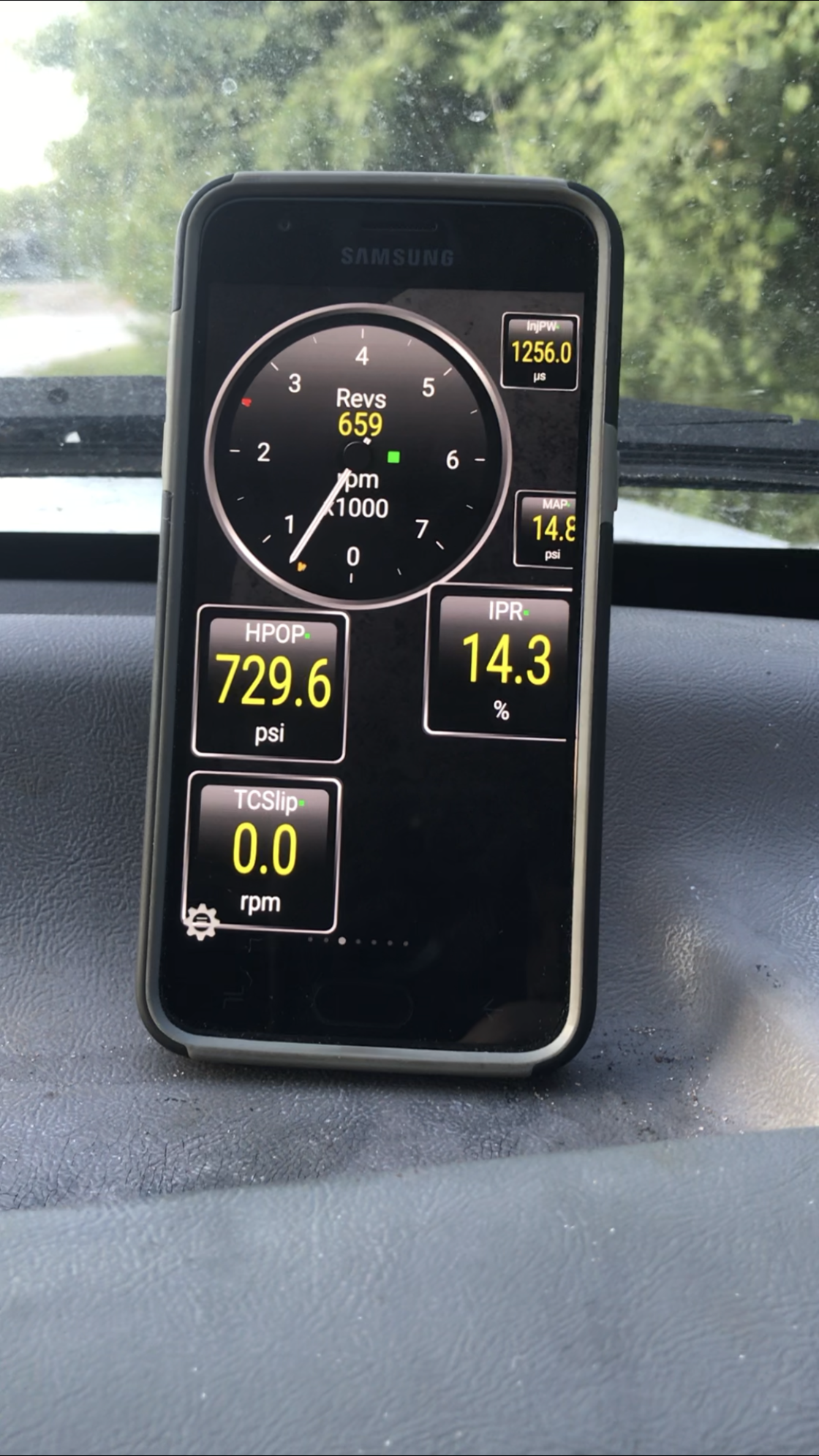

My numbers at idle cold.
My numbers to the floor a little warm. Ps the truck doesn’t rev higher than 2500 with a load. It is probably the slowest truck I’ve ever driven lol

I'm not seeing any significant boost (MAP) sensor, second small gauge on right side. Are both photos in the driveway during testing or one while driving? Did you forget to connect the MAP hose from passenger side intake to the actual MAP sensor, that would cause a slug of a truck? Just guessing at this point without additional information.
not sure if I plugged the MAP sensor in. One question I had was, what is the importance of the AIT sensor because I pulled a code for a bad AIT. Never read much on here about either sensor. I’ll search up the MAP sensor and see.

I guess what I’m really asking is does this seem like an IPR thing? I have to move the truck off the property this weekend cuz I told the guy I would. I’m going to check the map sensor if I can get by there today before dark. Is there anything I can do or check later tonight to help get us pointed in the right direction. And I should be able to answer any question you guys might have about the truck too.
and those photos are screens shots of me riding around with it. The one with the rpm’s at 670 is when I was idleing in the driveway.

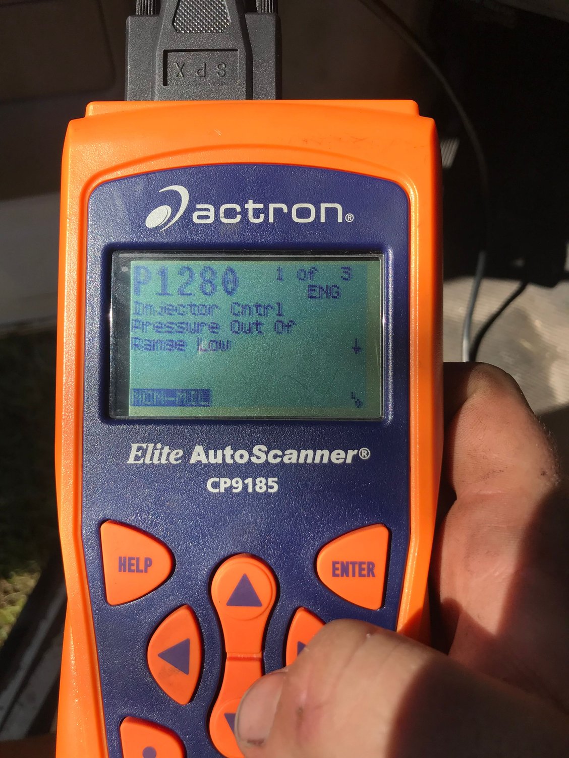

Posts: 336

For the P1280 I would start inspecting the wording to the icp
the P0603 is from the batteries being disconnected at on time. Nothing to worry about.

Measure voltage on the connector between pin B and the battery ground looking for 4.5 - 5.5 volts. Measure voltage between pin A & pin B looking for 4.5 - 5.5 volts. If you're readings are not in spec, you need to find a short in the harness

I’ve replaced the ICP already and inspected the harness and did not find any bare spots or anything that looks worn. I will test the voltage on it hopefully this afternoon.
edit:
You are talking about the connector on the ICP sensor correct? And what test can I do to the map sensor because in my data logging the only change in that map sensor was 14.7 at idle and then never went up or down more than 14.8. I’m thinking that might be my problem the more I think about it.
