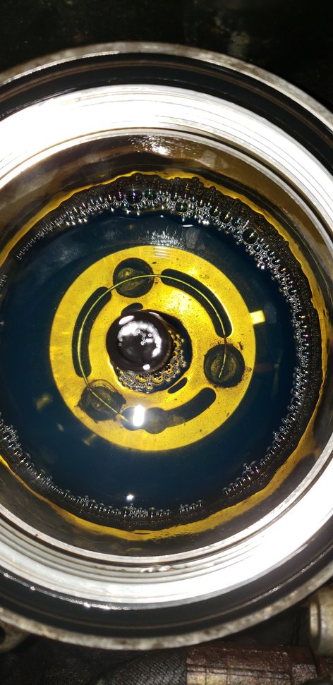

Your fuel filter warmer is on it way out. It broke, but not enough to do it constantly. It’s bouncing around and shorting intermittently and when you pull the filter it temporarily fixes it.
im will to bet that if you pull the filter the soldering points that secure the heating element in place are broken
Just a FYI, it’s not a a fuel bow heater. It’s a fuel filter warmer.
Ever noticed the bottom of the filter is metal ? That so the heating element
can warm the filter to expand the gunk on the filter in order for fuel to flow better.

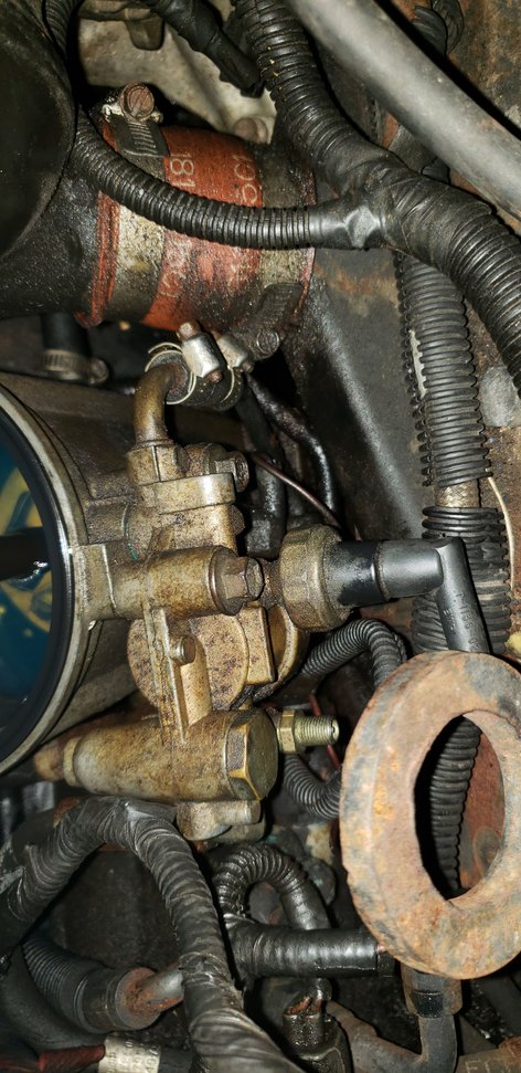

Sorry for. Ignorance on all that lol
Here's what it looks like

The heater is for reduced emissions at startup iirc

So I changed out the heater, cleaned the fuel bowl completely assured fuel was going back in. Changed #22 again with a glow fuse this time and it didn't blow and still no wts light. I don't have my multimeter.. But all the connections on the pcm looked good.. And I was worried since there was a ton of rain recently that it may have gotten in the connector or something and it doesn't appear that any water got in or anything.. Do you guys think I'm stuck with pcm needed or if there's something I may be missing? I had someone check my exhaust pipe for cranking without the light.. And there's a tiny bit of white smoke but not enough to tell without a light shining inside the pipe.
