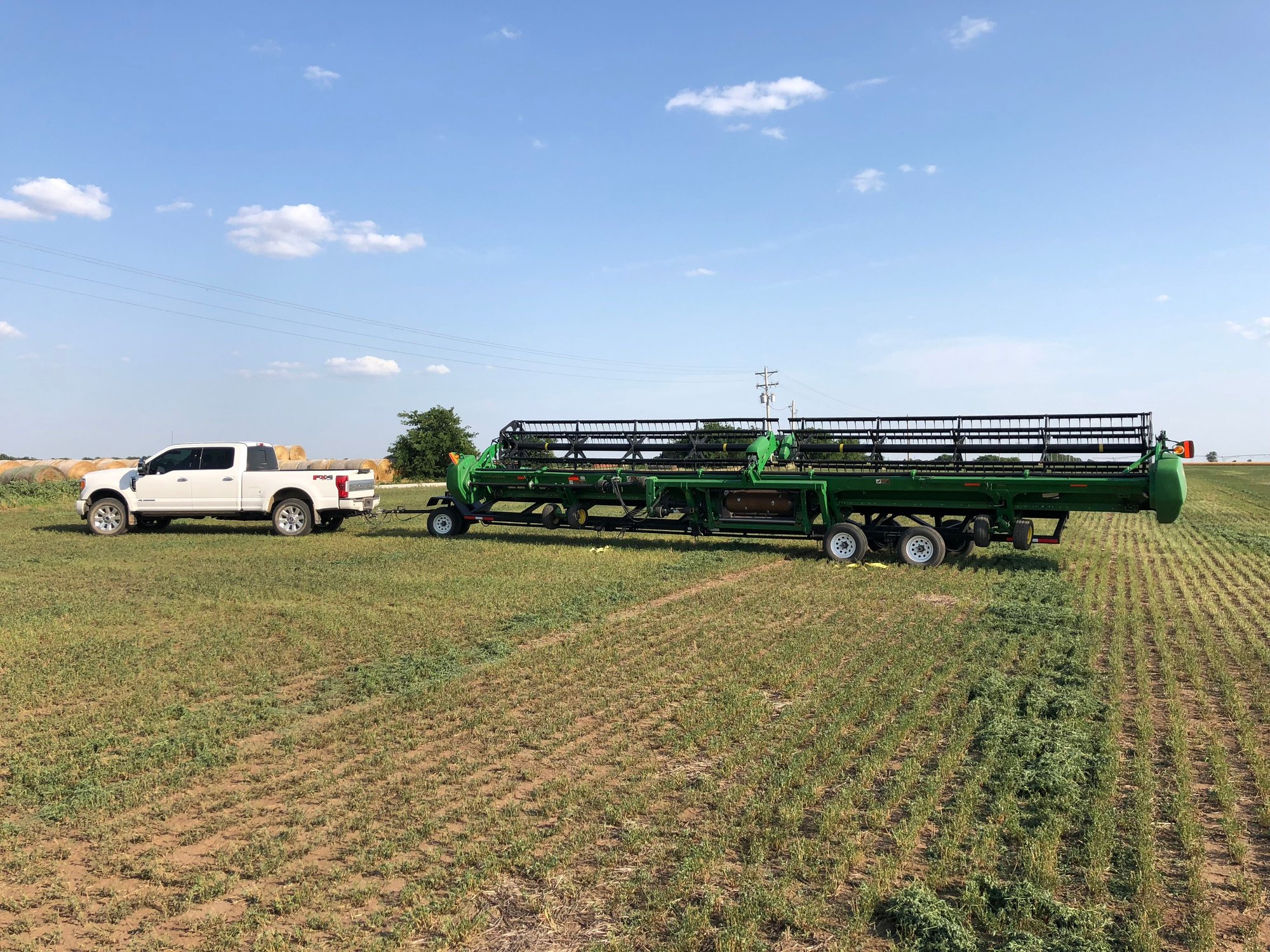

I leveled it by using the PMF 1.5” lowering blocks. Ended up lowering it about an 1 1/4” from stock by the time the shackles were installed. I don’t tow much, maybe 10% of the time. When I do tow it’s usually a lot of dead weight, as there isn’t any weight on the pickup. I do occasionally pull our 28’ gooseneck with a big skid or utility tractor, but even then the trailer handles the majority of the weight. I really like the shackles. There’s no doubt they help, and after hours of researching I wouldn’t be concerned even if I was towing heavy with them. I think the Fox 2.0 and the Sulastics would be a good combination.

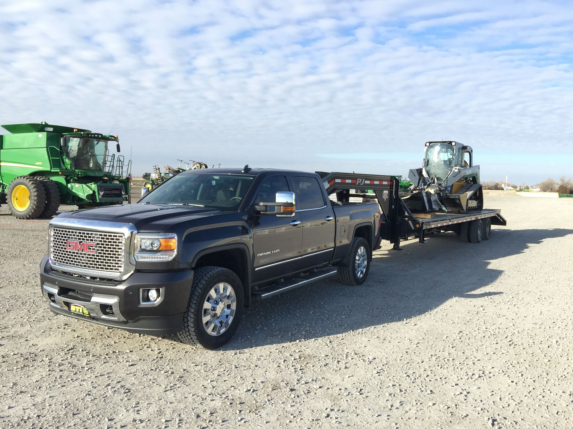

What I mean by dead weight.

I came from the GM side as well.
