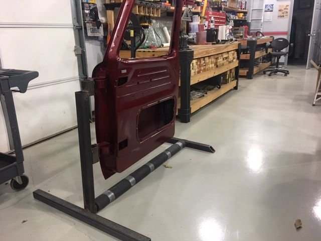

In the process of rebuilding the doors off my 62 Flare side after painting. I was worried about how to work on them by myself without damaging the paint. Searched and found some ideas here on the Ford Forum and made one in about 20 minutes. Now I can work it alone, move it back and forth and do not have to worry about damaging the paint.

Excellent, can you post the plan drawings/measurements?

Sure, I'll measure everything tomorrow and post it. I just used scrap I had in the shop.

Ooh. I like it. I bet you could adapt an engine stand to work as well

Height - 33 1/2"
Length - 50 1/2"
Back Bracing - 38"
Front Bracing - 26"
Top bolt hole drilled at 32 3/8" from ground
Bottom bolt hole drilled at 16" from ground
