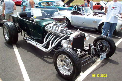

This isn't my car but I've had the pictures for a few years.
Anything is possible with enough time, energy, effort or money. Making a adapter/carb mount, that goes in place of the throttle body, may work. How well? Who knows! I don't think that is something very many people have tried. Just guessing it would probably work quite well at WOT ( think tunnel ram on a V8 ) . But driveability issues may pop up from the carb being so far away from the cylinder head. The fuel may drop out of the air fuel mixture.
If you want to try it, then try it. If it works, great! If it doesn't then you need to try something else.
